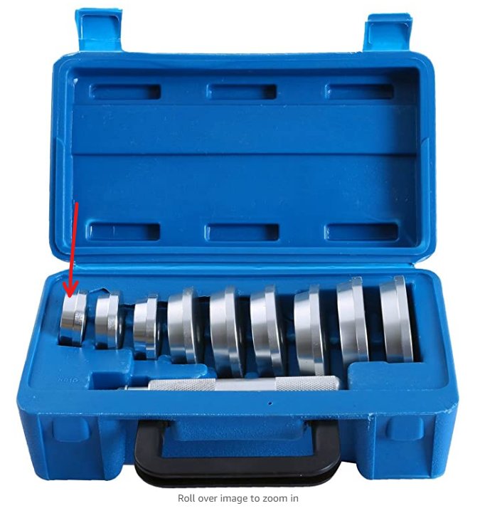

    For those of you who have installed, do we also need the bushing/seal installer tool?

    I have the bushing and seal installer. If you're in a newer truck and it's not leaking, I highly recommend leaving the old seal in place. You're more likely to cause a leak by replacing it.

    From what i understand you can just use a bearing and race installer tool. Either rent it from the auto parts store, or buy (and return) it from HF.

    This is true and how I installed mine. However, the smallest race driver that they have is too big for the bushing, so you end up using it kind of backwards. I've since obtained the ECGS bushing installer and it's properly sized to fit the bushing and installs much easier.

    This is the kit I originally bought and what most auto part stores offer... Note the diameter (red arrow) is bigger than the ECGS bushing diameter, so it doesn't fit. But when I used it, I just flipped the metal disc around and drove it in with the backside. It's easier for the tool to hit the bushing out of square, but just be cognizant and you'll be fine.
    Since my install though, I've obtained the proper tool from ECGS and it goes much smoother. Note the smaller diameter on the driver and it's made from HDPE, so it won't damage the material inside the bushing.
