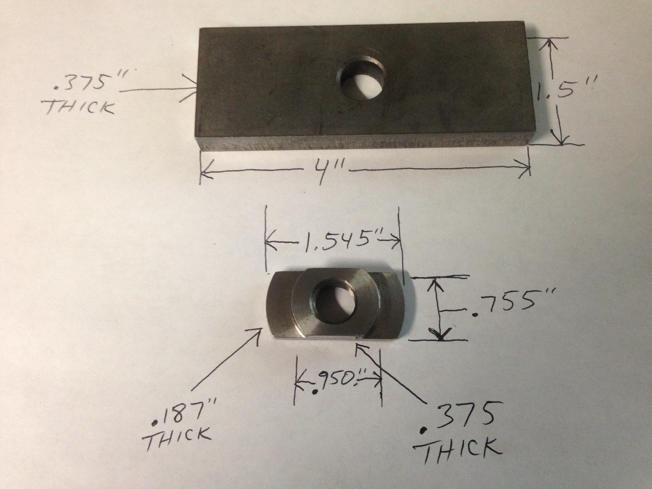

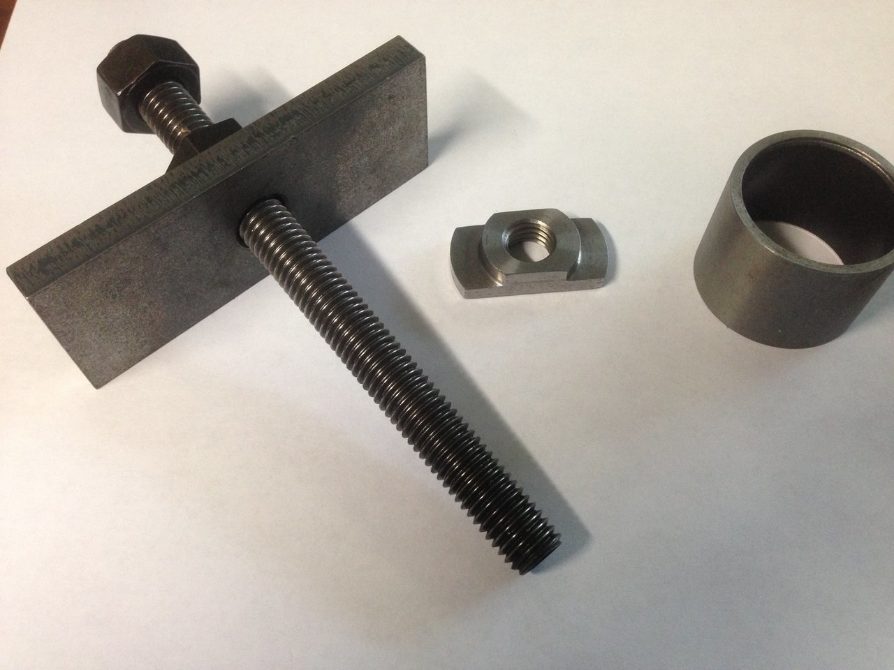

    anybody know the exact dimensions of the peice of the ecgs removal tool that goes behind the bearing? Got some material at work and I’m planning on making the tool myself....

    I know just a flat peice of steel, some all thread, nuts, and the peice that goes behind the bearing.. I will have to make it at work so unfortunately I would like to know the exact measurements of it..

    The OD of the bushing is 1.595". The dimension across the ECGS puller piece is 1.545". The thickness of that plate is .187" at the edge. It's .375" thick in the middle where the threads are. Hope that helps.

    The threaded rod is 1/2"

    Loosened the nut behind the wheel. ADS mid travel.
    Worked like a charm. Thank you for the info @Muddinfun .
    If anyone wants the one I built, let me know and I'll drop it in the mail.
    It's ugly but works great. lol, kinda like my truck.
