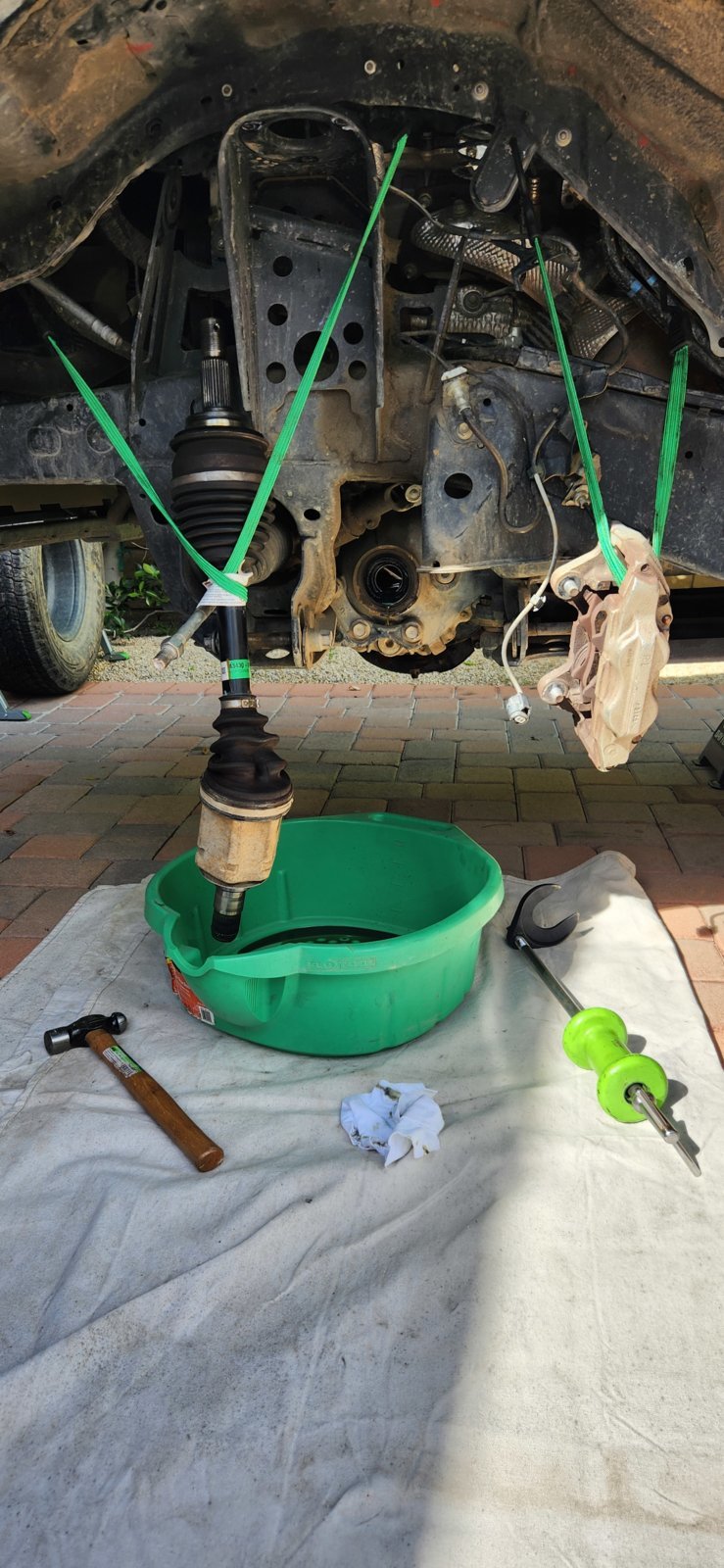

    I'm having heck of a time getting the axles out

    I used a long pry bar, maybe 3' from the opposite side (like a punch) and used a hand sledge, couple of taps and it pops out.

    I'm taking a breather my arms are shaking

    Ya try the prybar and hammer method and knock it out from the backside. Its kind of a pain if you try and pull it o slide hammer it. You just need enough force to slide the CClip in

    I find a big ass screw driver, placed on the notches of the CV body, smacked with a 3 lb sledge, takes a few pops and a few rotations, feels springy at first, but eventually pops free. Shouldn't need extreme force, but hit it like you mean it.

    I'll try again tomorrow. Doing this after work isn't helping either. Those notches are starting to look like shit too.

    Yeah, take a break and come back. Fresh eyes always help. Those notches are there for that purpose, they'll be OK.
    Be sure to rotate the CV as you go. Ultimately, you're trying to get the retaining clip aligned with the hole.

    I use a pry bar and pry between the differential housing and axle.
    It will bend the dust shield slightly, but that can be fixed easily once the axle is out.
    It doesn't take a lot of force once you hit the "sweet spot".
    The biggest thing is holding up on the axle. Don't let the weight of the axle rest in the differential.
    Hold up on it while prying. This takes straightens out the axle and allows the clip to pop free "easier".

    Victory!

    Thanks! Ecgs bushing officially done!
