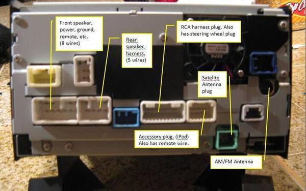

    I can't speak for JBL, but I just installed this this HU on my 2006 Double Cab without the JBL system. I do have the steering wheel controls.
    I WAS ABLE TO INSTALL THIS HEAD UNIT WITHOUT A SINGLE WIRING HARNESS. THE FACTORY HARNESSES PLUG RIGHT IN.
    I had multiple people tell me this wasn't the case, so just to be sure I bought the required harness. I matched them up with what Eclipse sent me and the aftermarket harness and THEY FIT PERFECTLY.
    I have heard of some people having issues with the steering wheel controls. That plug does not plug directly into the HU. There is a female receptor on the RCA harnesses that you plug the steering wheel controls into. You plug the steering wheel plug into the RCA harness receptor.
    Hope this helps!

    Correct. I needed nothing aside from the dash kit.

    Here is a labeled pic of the Tacoma's factory wiring. Hope this helps!
