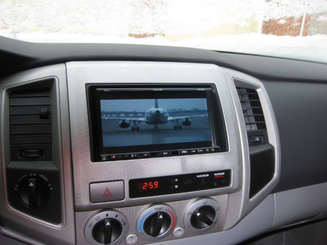

    Just got my Eclipse AVN726 Installed
    IMG_0877-1_f46fee3accebda7b11c7427da93356be46f4d655.jpg">Video at my other job

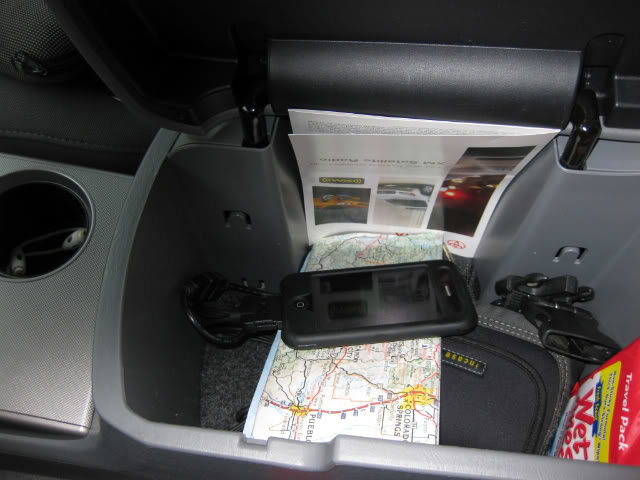

    IMG_0876-1_18c783db7e959cb16177598a4bcd832b5d5df41c.jpg">For Security we mounted the iPC-709 in the Glove box. The installer Eric from Highline Audio in Denver also made it possible for me to disconnect the iPC cable and hook right into a USB giving me a dual USB function.

    So far I am very impressed. made it possible for the back up camera tp appear in the display as well as on the mirror.

    I have the same deck. Excellent HU...just wish I can customize my own wallpapers.

    Yeah the wallpaper would be cool. The on screen DVD menu seems to challenge ne right now. Any suggestions?

    How did you do that? I'm interested as the small display in the mirror is very hard to use effectively.
