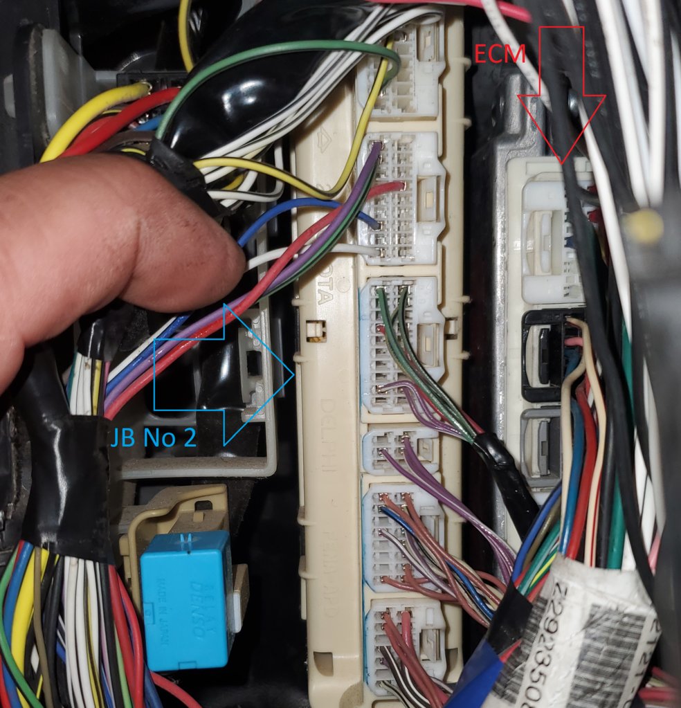

    Do you mean physically getting to it?
    If so it's right behind the glovebox on the right, not much to it.

    The bracket it's mounted to is a bit tricky to get out but it's only a couple bolts if I remember correctly.

    Yeah, it looks really tricky and I have no idea how to get to it
