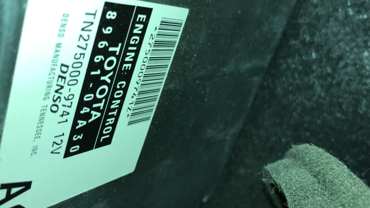

    641A3453-67C2-4B8E-A0E4-B4E16F845938.jpg I stuck my phone in from the side of the ecu and was able to get a photo of the part number

    I can confirm that this works. Just swap the auto ecm to a manual ecm as part of my manual transmission swap.
