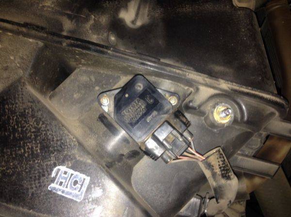

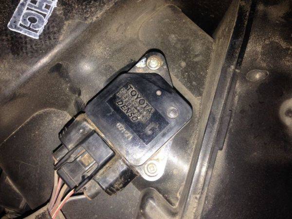

    The 13 might use our Q3 which is in production, can you take a photo of the MAF sensor so I can confirm?

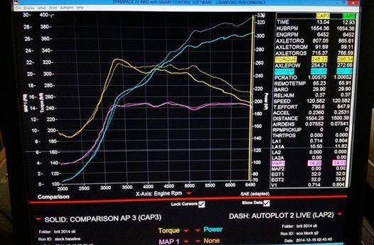

    What type of dyno have you used to gather this data, or are you just guessing?
    These dyno runs and accompanying graph I did clearly show a rather large power increase, and if you look at the AFR data you will see that the the higher power was made with less fuel.

    Are these good enough?
    Thanks, Diego

    Perfect, that style is Q1

    So based on your comments and most of the negative comments we've read here, the MAF controller from URD is shit! Cause it's exactly what it did, tinkering the MAF readings.
    So based on your comments, the most fuel youre dumping better is the power! So for you having an AFR of 10 or less at WOT is OK and is producing a lot of power! Producing an AFR of 10 at WOT is not dumping fuel, It's wasting fuel.
    The flash in the Toyota ECM is producing way to rich AFR at WOT and it's why a lot of guys here using a MAF controller from URD to maintain an AFR of 11-11.8 with boosted application. Same power, even better with less dumped fuel.
