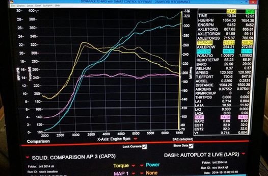

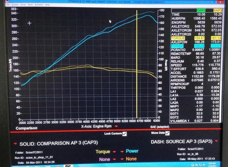

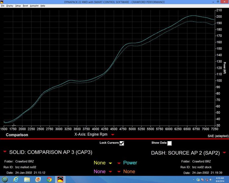

    Thanks for thinking outside the box, here is a before and after dyno.

    Those are data points, but most of us understand that there is a difference on how our, for the most part, v6 4.0's react to mods then performance oriented 4's.
    There is still definitely a question about how this affects closed loop operation. Dyno and 0-xxx runs are all open loop and for the most part read fuel pulse widths from an ECU table. Closed loop is going to use the MAF sensor, but predominately uses the AF sensor to set pulse width.

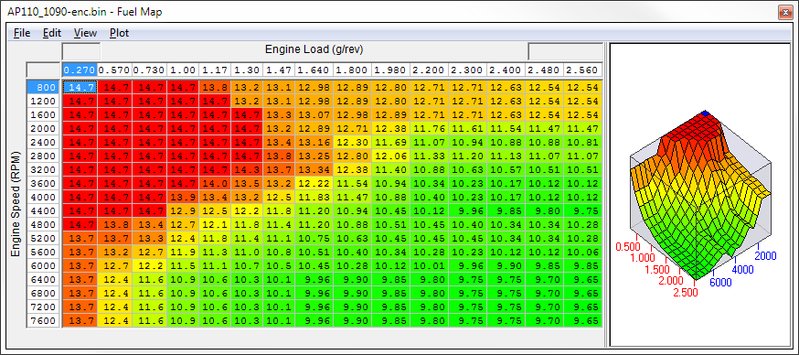

    The Eco Block changes the X axis of every load based table within the Engine Control Unit. Depending on the car we are speaking of these load tables will control, fueling, ignition timing, variable cam timing, shift points in an automatic transmission and boost pressure on some turbocharged vehicles. By changing to a different row on the table, the output from the table is changed because it used a different number in the equation for the output. This graph is different as the Y axis is for load but it gives you an idea of what I am speaking of.

    But aren't these the open loop tables?

    Sorry dude, I assumed from your prior comments that you understood how the open and closed loop fueling concepts within the ECU worked. This last question from you opened my eyes to the fact that I lost you when I talked about how the engine control unit functions. After 20 years of tuning I end up thinking it's common sense and everyone understands it ;)
    The term open and closed loop fueling "only" relate to a few of the hundreds of maps found on the ROM within the ECU. These are look up tables which the ECU uses to compare the AFR that the Lambda sensor is reading while in closed loop fueling so it can trim the ratio to Stoichiometric. That said, all the tables I mentioned above are indeed active during open loop and closed loop fueling compensation.
