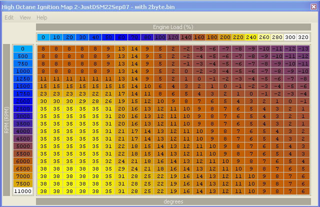

    Quirt,
    I'm curious.. This product is in effect tricking the MAF into reading less airflow than is actually entering the engine by placing the metering area closer to the walls of the intake tube.
    When the ECU gets the inputs from the MAF, IAT, CLT, TPS, CrnkPOS, CamPOS, etc. It's going to determine a load cell for the given RPM. Others not familiar with what I'm talking about can see below (while not a Tacoma, this is a representation of how the timing map in this case is programed within an ECU) X axis represents the "load", and Y axis represents the RPM.
    With this product altering the relative signal reported to the ECU with values less than actual, this will put the vehicle in a lower load cell(s) compared to an otherwise stock vehicle. While transitions from cell to cell are not likely and in most cases, should not have large transitions, running in a load cell above or below "stock" shouldn't be much of a problem under normal circumstances.
    But here's where my curiosity lies, with the MAF reporting less airflow than the engine is ingesting/burning in combustion, the O2's are going to report a leaner mixture and short term trims will adjust, shortly after with a sustained "leaner" mixture, the long term trim will take effect. Essentially returning the vehicle to the programmed mixture (AFR) Toyota programmed for closed loop operation.
    Does this part modify the reported MAF signal enough to essentially max out the STFT/LTFT to effectively lean the vehicle out in closed loop? Or is this simply designed to lean out open loop operation?

    I am curious too. Otherwise there would be a lot of people with CEL's for lean codes.
    Now i never checked, since i didn't care to, but with my adjustable FPR, I dropped the static psi for the fuel from its stock pressure @~43.5 down to ~39. So while under full vacuum(idle) it was somewhere around ~35. I did this to lean out the high RPM AFR, while driving/racing. Used much less fuel from one track day to the next. Also stopped burning as much on my daily commute. Point is, that even with that lower pressure, it didn't skew the fuel trims enough to set any CEL's and picked up fuel mileage. Just something to add to the mix.

    The results you posted, were those on the stock ECU? Dropping the fuel pressure is achieving the same thing, but the Eco-Block is airflow dependent whilst the fuel pressure modification is completely independent. Overall the observed result should be similar anyhow.
    I'd speculate the reason you saw mileage increases during your daily commute is a by-product of you being in open-loop more than "grandpa" driving to church. If you'r not maxing out the fuel trims, the truck is running (or trying too) at whatever lambda value/afr is programmed.

    The load axis on the graph you posted is derived from the MAF sensor, so every table like the one you posted which uses load as an axis is effected by the Eco Block. The other sensors you mentioned add a compensation to the output from this graph.
    Correct, the EB causes the ECU to read from a different load cell which has a different number in it which changes the mathematical equation for that function.
    When the ECU is in closed loop fueling, the air fuel ratio will be what is listed in the table. The ECU will use the information coming from the O2 sensor to trim the AFR until it matches the table. If it cannot get to the desired AFR listed in the table then it will toss a check engine light to let you know that something is wrong. 25% is usually the maximum that the ECU can trim. So, when the ECU is in Closed Loop Fueling the AFR will be what is programmed into the table from Toyota.
    I only use about 15% of the available 25% so the ECU is happy while in closed loop fueling. That also gives me a cushion so my customers are not on the edge of having a check engine light coming on. So yes, you will not see better fuel mileage from a reduction of fuel injected while in closed loop fueling but you will see a small increase from the increased efficiency gained from the advanced ignition and cam timing.

    Awesome! Thank you for the reply.
    I posted the timing table (from my old Mitsubishi EVO) to give others an idea of what I was talking about. I'm sure many here haven't seen that before and didn't want to lose anyone.
