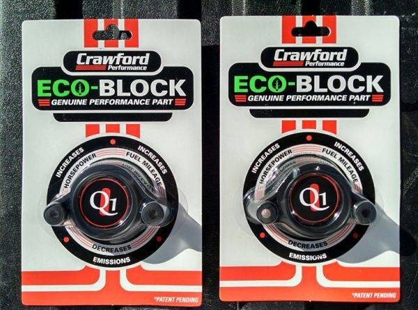

    I received 2 in the mail yesterday; one for my Tacoma, and one for my wife's Highlander. I have 5 years worth of detailed fuel mileage tracking, so lots of data history to compare with, and will update this thread with my experience.
    Thank you to Quirt and Jon, both great guys to work with. I've been a fan of Crawford's work since becoming a Subaru enthusiast well over 10 years ago; definitely a highly reputable name IMO.

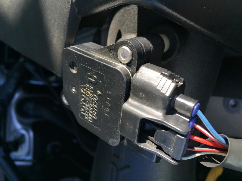

    Chiming back in to confirm the maf spacer DOES WORK with TRD gen 1 intakes and AFE stage 2 intakes. All you need to do is go buy M4 x .7 pitch x 35mm long bolts at somewhere like ace hadware, where I found mine. $1.20 a piece and they're stainless steel. No check engine lights or weird signs. Seems to be working well. Truck runs smoother I think, could be a placebo. Who knows, but I'm happy with it. Starting a new tank of gas today so I'll keep track of the mpg.
    Edit: sorry for the sideways picture, posted off my phone.

    Thanks for the info! So are the threads recessed in the intakes so the supplied bolts / screws are not long enough or is the pitch different?

    Pretty much, with the TRD / AFE intakes they have these little white plastic spacers that go under the maf sensor so the screws just weren't long enough to make it through those and the maf spacer together. But the 35mm ones work perfectly. Pitch was the same.
