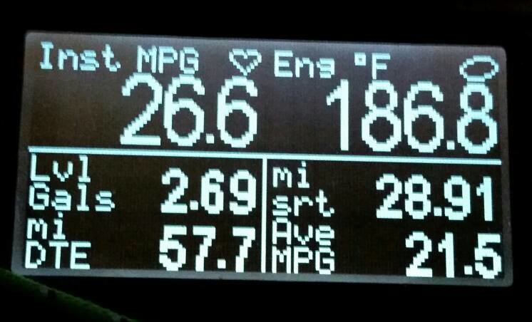

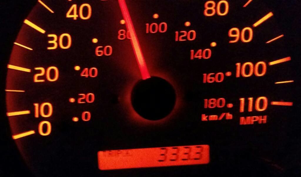

    New update:

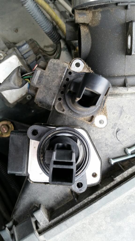

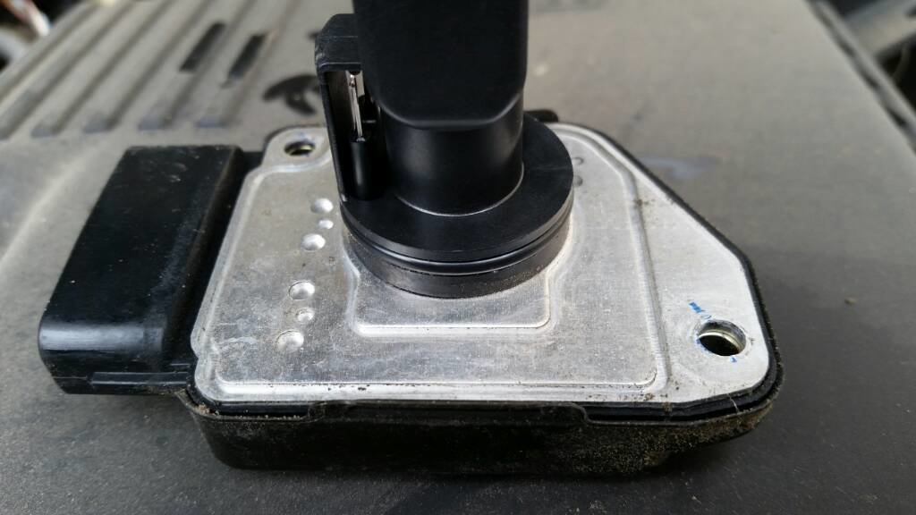

    Quirt, here are pictures of the 2003 Toyota 4Runner with the 4.7 V8 MAF sensor with the Q1 on it. The other MAF is off of my 2004 Toyota Tacoma:
    Close up of the underside of the 4.7 MAF:

    Thanks for that effort Darryle!
    Very similar but different ID and bolt spacing... Looks like its time to get Q5 into production :)
