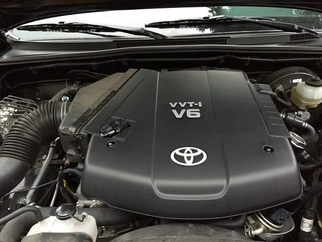

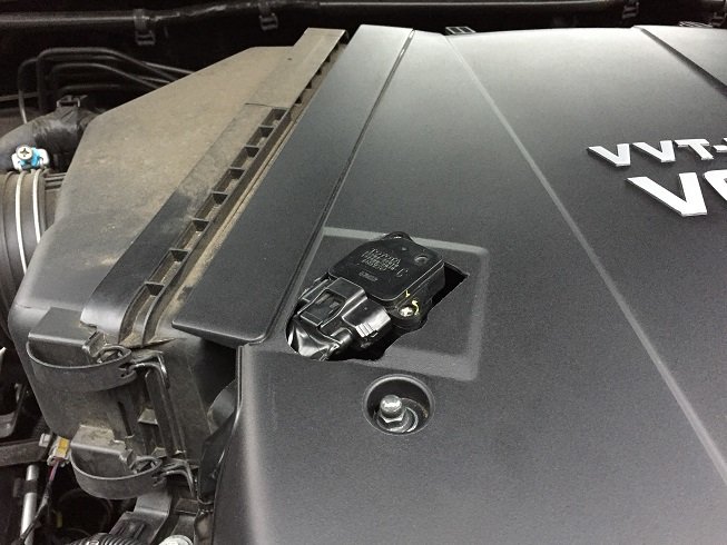

    I installed mine today.
    A few comments about the install:
    First I thought screws that came with unit were a little on the short side. I noticed that the factory screws went further into the intake plastic.
    Second the factory MAF sat loose in the ECO-Block. The internal diameter of ECO-Block is a few mils too big and doesn't allow the O-ring to seal between the two. This could cause potential air leaks, I might try to find a larger diameter O-ring to allow for a better seal.
    Overall the install was simple, it took me 5 minutes to install and 2 hours to cut and shape the engine cover. I will follow up with mpg feedback in a few weeks.
