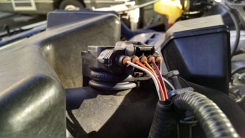

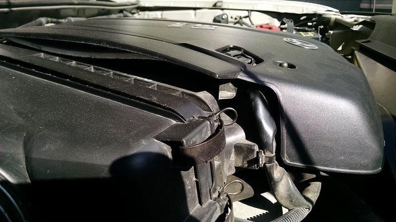

    I have 2 Q1's I'll sell if anyone is interested for $20 each, shipped. I ran them on my '06 V6, and on my wife's '01 Highlander V6.
    I saw no power difference on my 4.0, but I definitely saw an increase in low-end torque on her 3.0, where it previously had noticeable lag. I only ran them about a month, not long enough to get fuel mileage data.
    I mostly removed them because I didn't want to cut my engine cover, and it bugged my OCD having it push up on the cover, though it did fit fine without cutting the cover. I removed the Highlander at the same time because my wife didn't really care about it.
    Tacoma
    Highlander

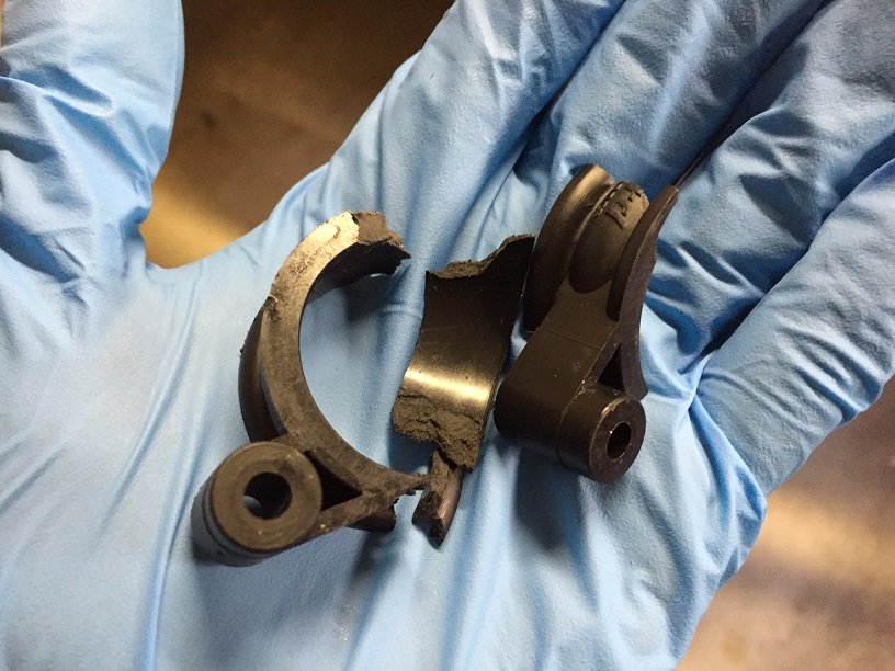

    I removed my Eco-Block today and was going to offer it on here for free.
    Instead I decided to put it out of its misery.
    There all fixed. :smash:
