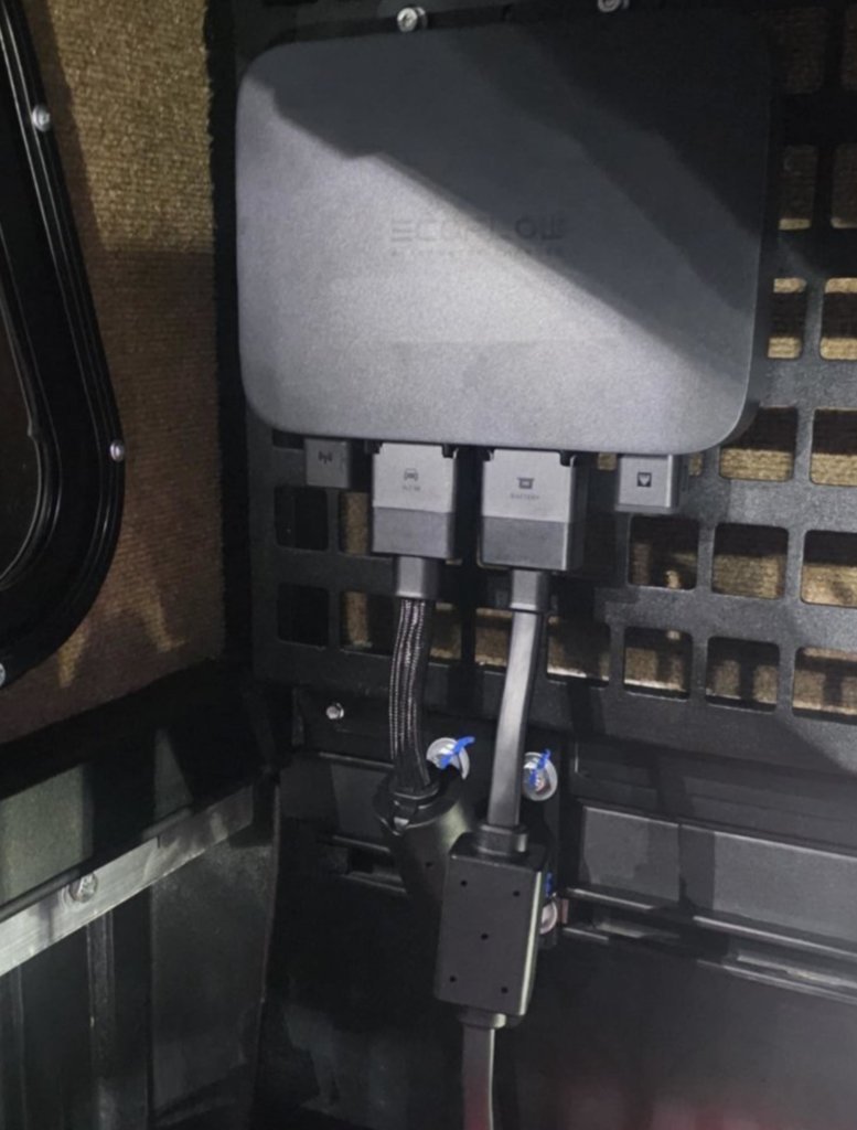

    Got mine on the back on the bed of the truck... I love the functionality of the setup with the ecoflow delta 2....
    Daulll likes this.

    I too did an install on the head of the Molly pnl in the camper shell. I think I love this more than anything. Beats the double battery install and cheaper with more bennies.
