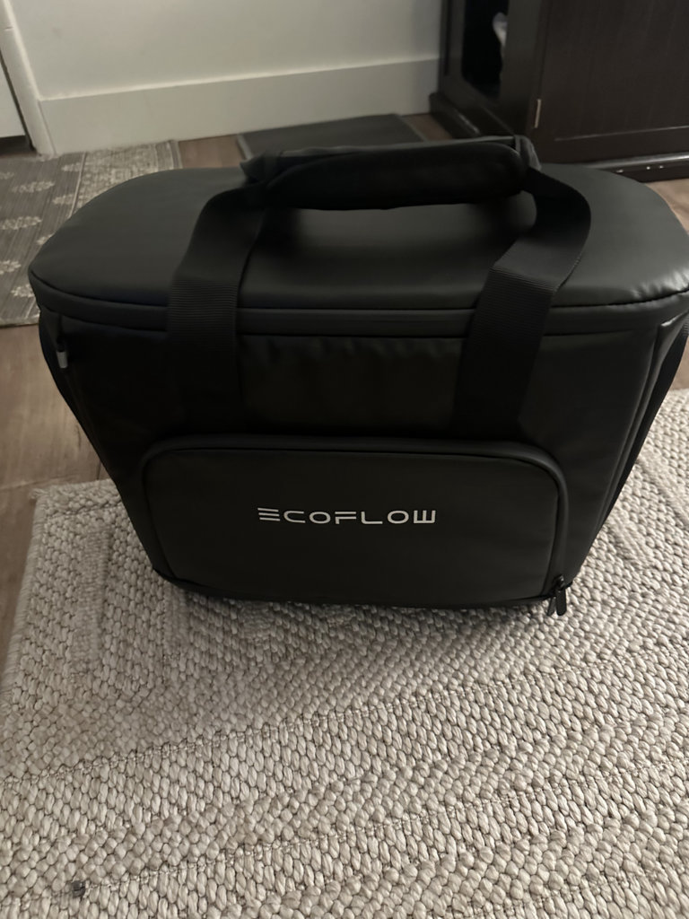

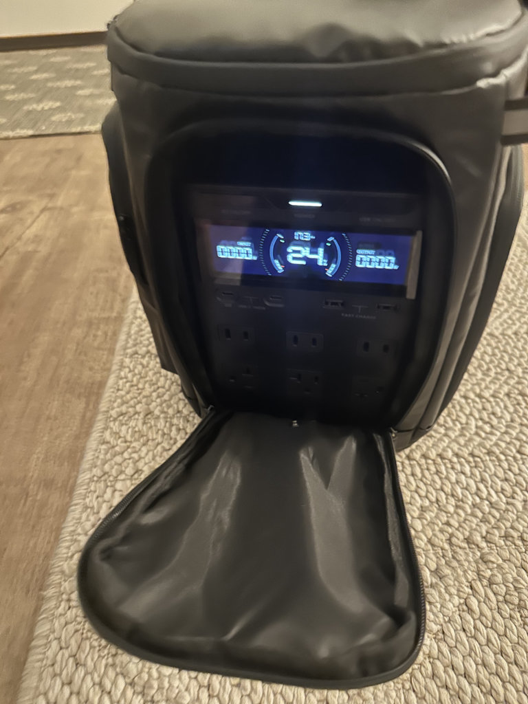

    Just got my Delta 3 plus delivered. Got it on sale for 619$ with the free travel bag. Will be testing the Gen 3 400w inverter to see if it works with the new model tomorrow. Probably won't so here's to hoping this 800W alternator goes on sale again soon!
    el_turks likes this.

    Just checked and confirmed the new DELTA 3 does NOT charge with the Toyota inverter will be getting the ecoflow inverter soon!
