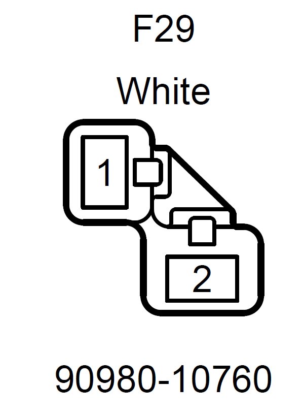

    If someone has a couple good pics of the connector you are after I could have a look.

    12V power outlet connector. If there was a male & female version of it that would be sweet. It's just a Faston style terminal housing, but I can't find this particular configuration anywhere.

    Wunderslug has a female to male spade connector that is a single piece that worked great that I’ve not been able to find where he got it. The smaller one wouldn’t fit and broke, so I just made my own version with a male and female spade connection and hooked it into his adapter.
