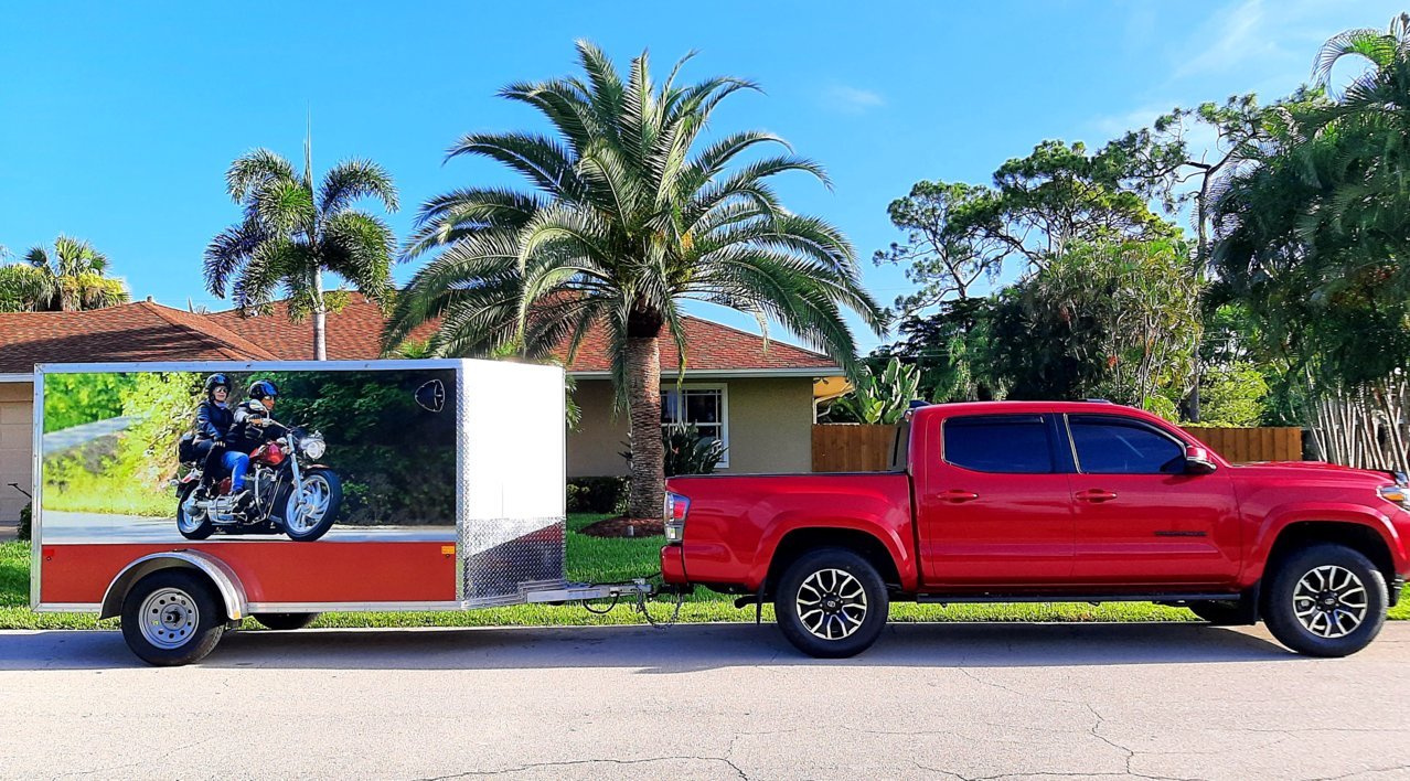

    20220814_083917.jpg Trip report----ATF readings in Fl. and Ga. traveling at 75 MPH (no cruise control) using 5th on flats and downhills and 4th on up hills were between 195 and 210. In the mountains of Ga. and NC traveling at 70 to 75 MPH the highest it got was 220 (very briefly) but stayed between 200 & 215 depending on Tranny shifting. Gears in the mountains between 3rd (up steep grades) and 5th (downhill-flat). Gas Mileage report---- 13 MPG average on trip--best 14 MPG, worst 11.26 MPG (mountains)

    How much weight were you towing?

    loaded aluminum 5'X10 trailer with motorcycle (approx 1900# loaded)
