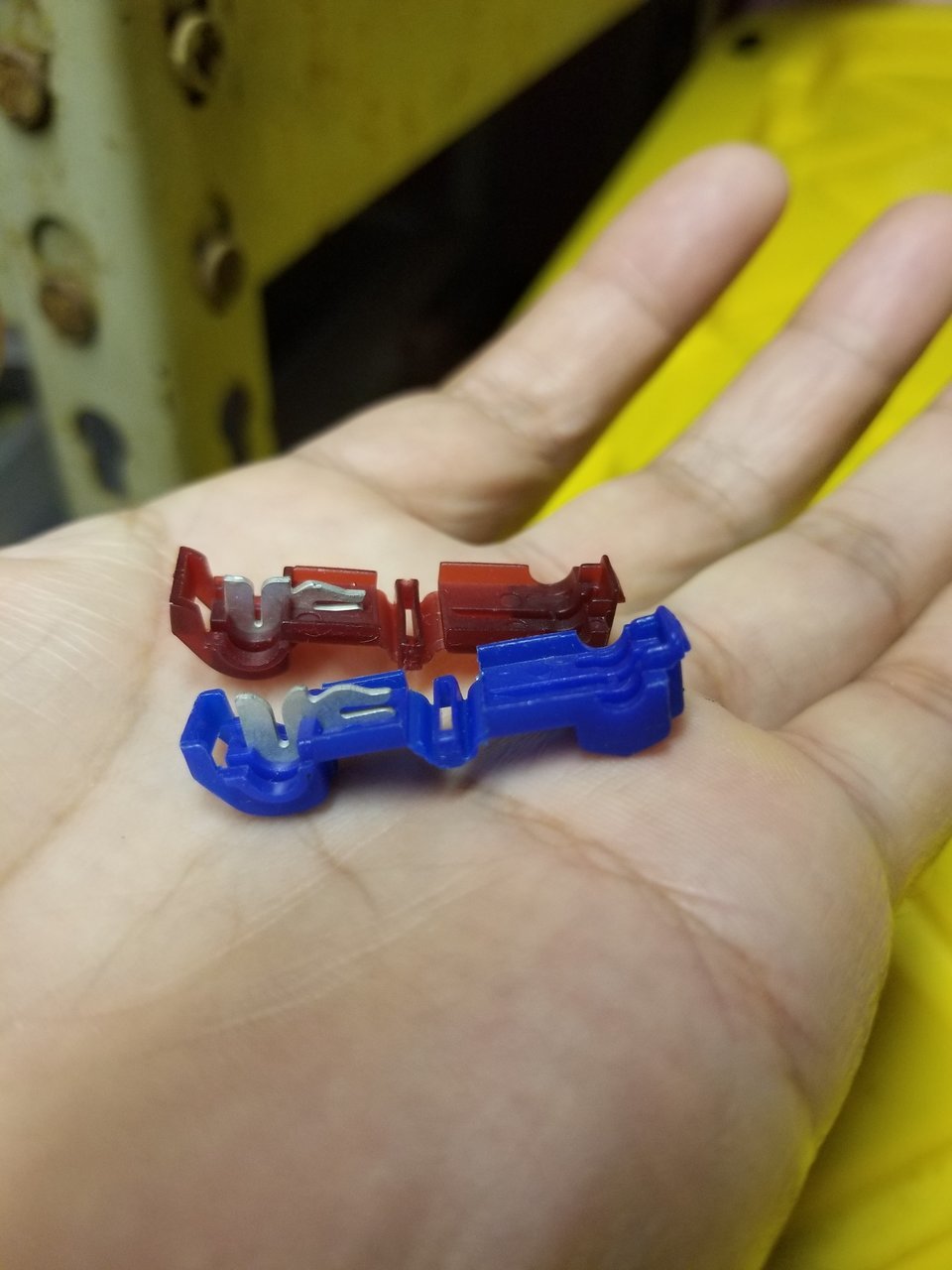

    Just received mine in mail today. I see you used a red tap. Wonder if you should have went with the blue taps for the cigarette wire due to larger gauge. As with the other poster who said he lost signal, the smaller red taps can sever the wire as another poster suggested. I still have yet to install but based on my past experience as a stereo and alarm installer this could be what happened.

    I used the red... had no issue. I think the blue is too big, as the cig lighter wire is 18 awg.
    The OP with the faulty cig lighter used the "add-a-fuse" not the wire tap.

    The issues was at the fuse box with the add-a-fuse. I am fully aware that too smal of a tap can break the wire, but the cig light wire is 18-20AWG. The blue may work, but might have an intermittent connection.

    That might be true for you but not necessarily for others. Plus, bert yours could still sever later. I'm not criticising, just offering my 2 cents to an already good product.

    Like I said, I haven't even been in there yet to see the gauge of the cig lighter wire. So 18-20 awg....wow wow that's tiny and yes could make an intermittent connection with the blue connector.

    All good, I like to accept all ideas and criticism:) . I suggest soldering whenever feasible, but I just included the connector as an option. I was a 12v installer for half my life, so I have seen t taps sever wires.

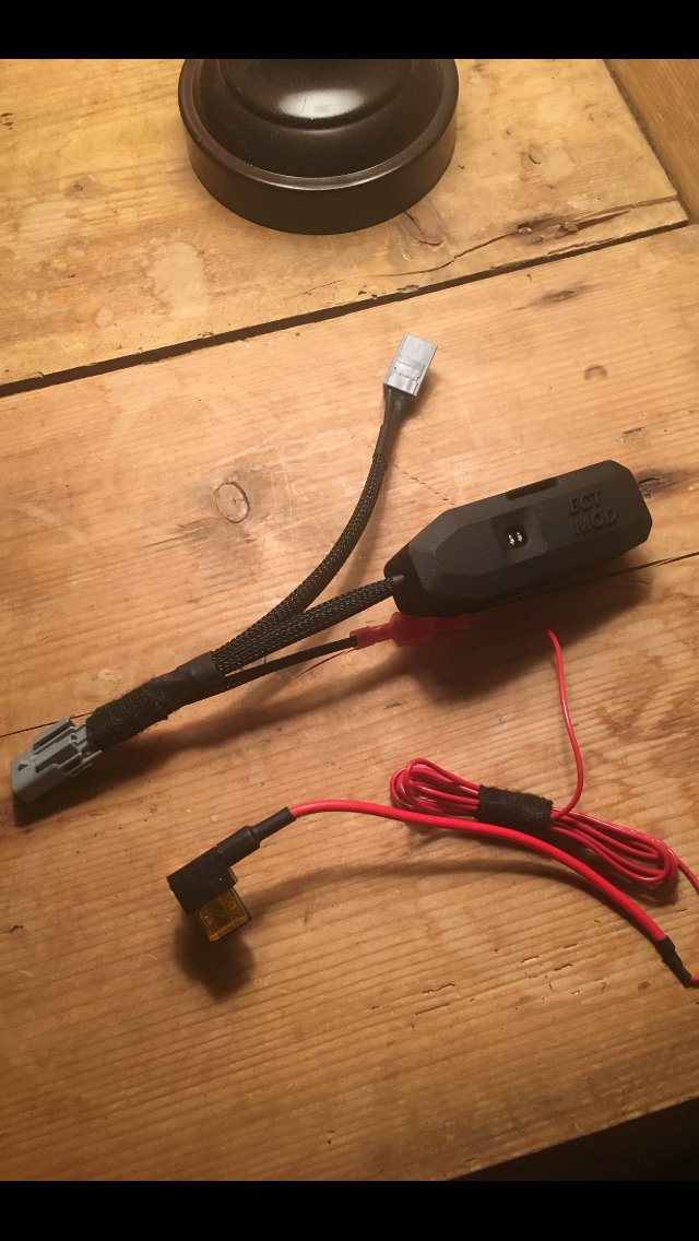

    Santa came today :taco:
