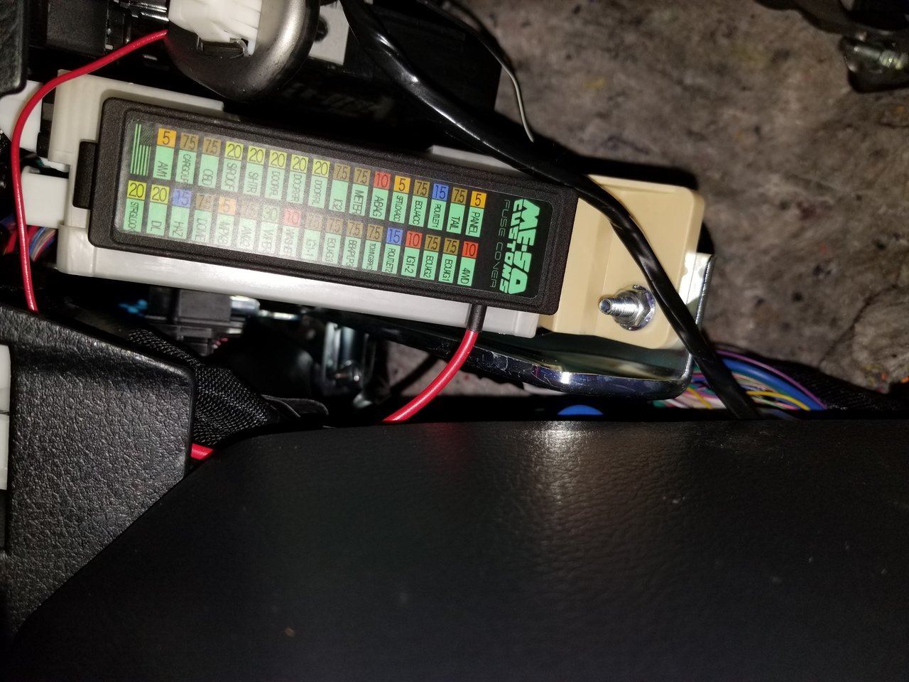

    So my fuse cover arrived today. I just have to say that I have no idea why this simple cover makes me smile. I mean the mod itself was cool enough but didn't really see it. But everytime I look at this cover it cracks me up. It has the appearance of like an 80's video game. Haha. Meso I would like to see more cosmetically appealing stuff from you for my truck. Like maybe some under the hood stuff or something. Or maybe like some cool switches. 20171115_185144.jpg 20171115_072331.jpg

    Okay,
    So I tested this out and I figured out why.
    When you power the truck on with 1 click to ACC.(if tapped off the CIG lightercircuit) it gives power to the ECT MOD to do it's thing. And it does. The only problem is, power isn't on to the rest of the truck(gauges, other ignition stuff, etc) for the ECU to see this command.
    So you go to 2nd Button/Start and it doesn't kick on. That's because the ECT mod already did the bypass when it had power the first time.
    Fix? Switch the power lead of the ECT MOD to a INGITON only power(not ACC). Then You can keep the truck in ACC/1 click mode and not worry about it deactivating.
    If that makes sense?
    I always hop in and start the truck full press so I never caught that.
    Haha 80's video game FTW. And I am also working on something for under the hood. :D
    Throwback.
    FYI anyone that has more than 6 wires coming out, or in an awkward position..the walls are thin and Can easily be modified with a slot from a dremel or razor blade.
