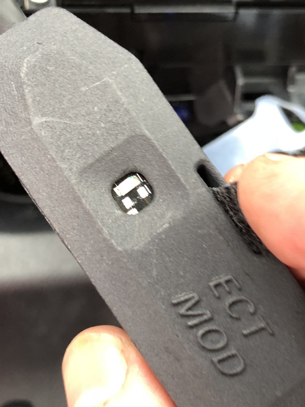

    Anybody have an issue where the module turns green after activating (holding 5 seconds) and then I turn ECT on as shown in the video. However, when I restart the car, ECT is not on.

    Interesting. No red light on mine. Only green light and no light.

    That's strange. I tested all of these in my rig before shipping em out.. it still works correct? Just no red led?

    No. It’s not working. Pulled the panels off again just now and it looks like there is no red light soldered to it. The packaging wasn’t damaged and the case has no signs of impact.
