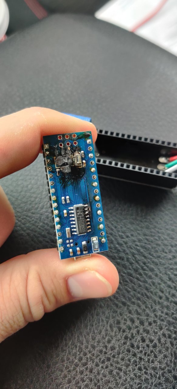

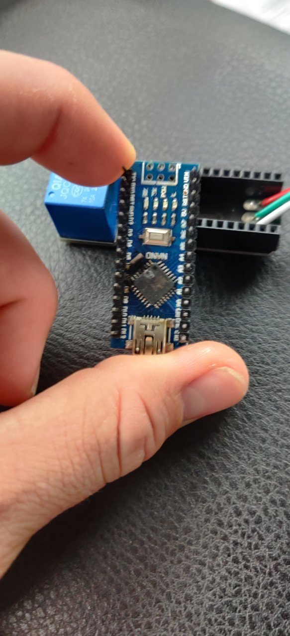

    On the original device this thread was started on, I did a RCA (Root Cause Analysis) and found the voltage regulator is what failed with the 3 devices I looked at, so I assume that's what caused all the failures. I looked up that part number and found that it's absolute MAX rating was 12V. The vehicle runs at 14V to 16V with sometimes spikes exceeding that. In my findings this is what caused the failures on all the original devices.

    So I'm still sitting here with a burnt unit, any new news?
