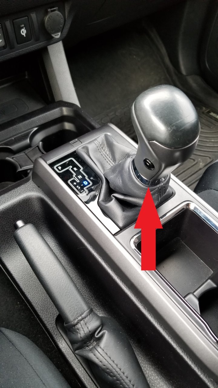

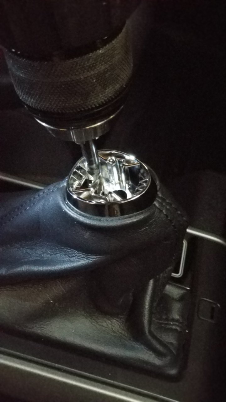

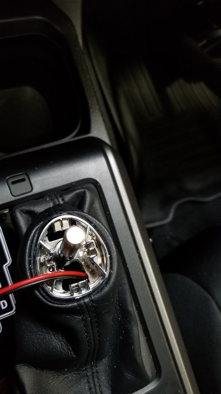

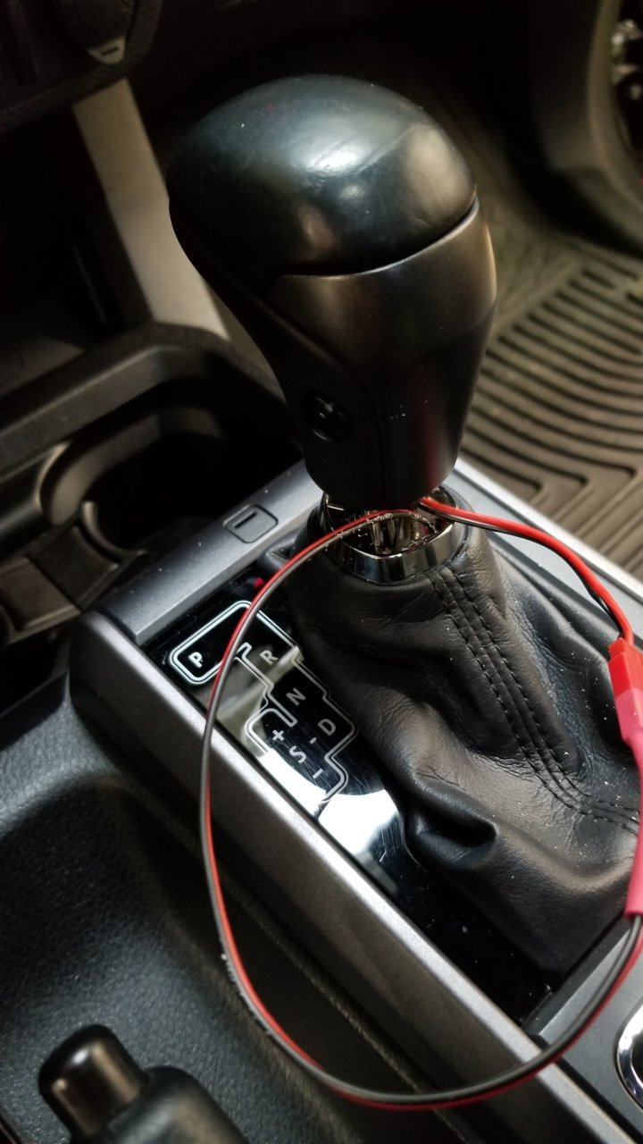

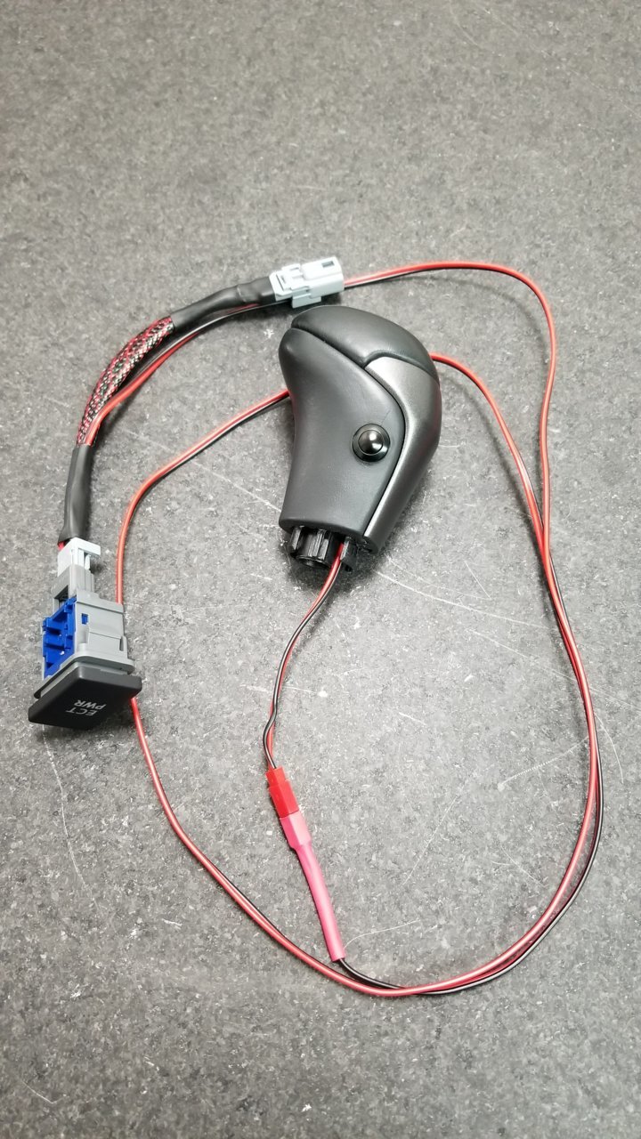

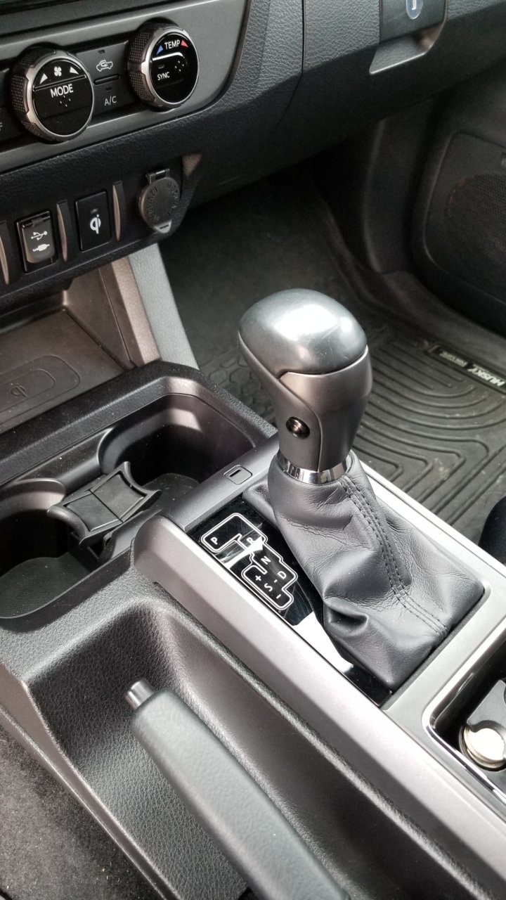

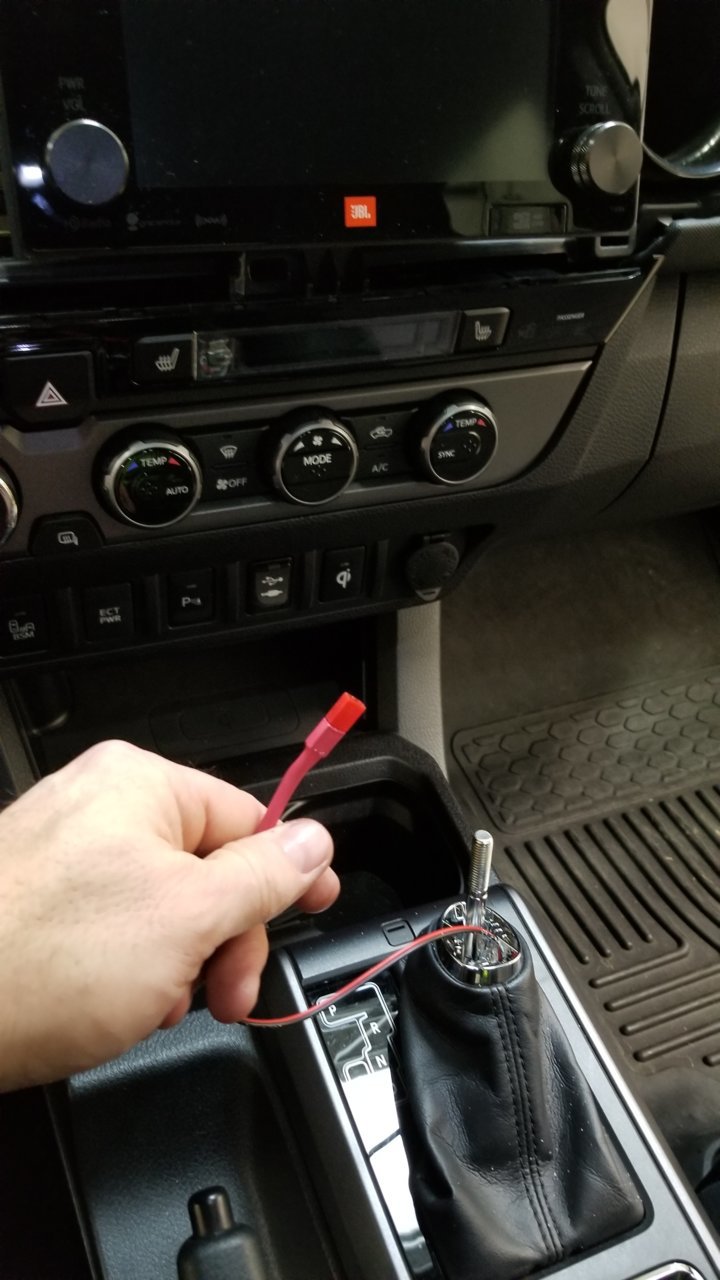

    I never really liked the location of the ect button, so I decided to move it into the gear shift knob. I’ve had the parts to do the mod but just hadn’t gotten around to it. Once I flashed to ovtune 1.05 and realized how much I like the tune with the ect button on I decided it was time to get this done.
    After figuring out the parts I would need and making the harness, the actual installation was simple. The harness I made just plugs inline with the existing wires. All the trim pieces that needed removed just pull off, no tools required. Running the wire from the button to the gear shift boot was pretty straight forward as well.
    The only modification to the truck was the gear shift knob and the bezel thing right below it. I needed to drill a hole in the bezel for the wires to go through.
    All in all, it turned out well and was a lot simpler to build and install than I was expecting. Even though I never used the button much I always found it annoying to turn on. Or maybe I’m just that lazy and didn’t like having to lean forward and straighten my arm. Regardless, it’s a lot more convenient to use now. My favorite thing about the button being in the gear shift knob is being able to turn it on without having to take my eyes off the road to look for it. Being on the gear shift knob it’s easy to find.
