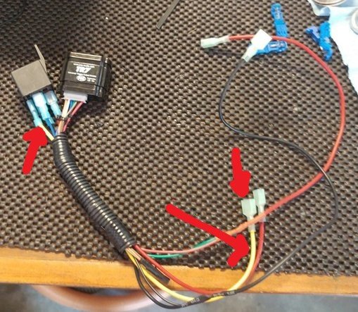

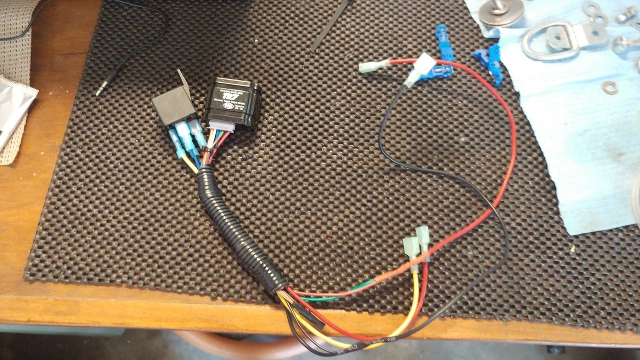

    Built it like you see there. Maybe 15 mins of work.

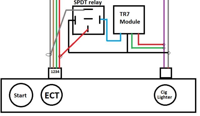

    I'm looking at building this. I looked at the whole thread an found the following. Do I need more to accomplish this?
    Parts
    12V relay (see below)
    Pac TR7 module (see below)
    16 awg wire
    3m T-tap connectors
    Relay connectors
    (other wire maintenance consumables...zip ties, wire tubes, Heat Shrink, etc)
    How To:
    1)Wire up Relay;
    Pin 86: Ground
    Pin 85: -->blue wire of Tr7
    Pin 30:--> Pink wire on ECT button (pin 4)
    Pin 87:--->White/black wire on ECT button(pin 1)
    From TR7 - Blue wire to SPDT pin 85;
    ground to cig lighter ground;
    green wire and red wire to cig lighter power.
    Finished Product

    Ironically I did this exact improvement the other day, I intercepted the wire going to the ECT momentary press (in my harness picture above it's the yellow wire) and stuck a toggle switch to the left of the BSM button in that triangle piece of that panel. Essentially in the "ON" position ECT kicks on. In the "OFF" no ECT.
    It's unlabeled because then people won't know what it does, and it only matters during that brief moment when the unit gets the pulse, so you can flip it after the truck is started and it doesn't do anything. That way if I get warranty work done I can disable it before I go in, and since it's unlabeled they will likely leave it alone and not know what it's doing unless they pull the dash and trace the wires.

    LoL. I would like to know what wires is the ECT momentary yellow wires ur talking about. Probably will do the same since you've done it and it worked.

    He's referring to HIS yellow wire. Not on the truck. Looks like it's the one going from pin 87 of relay to pin 1 of ECT button. Intercepting it will just stop the ECT from completing the circuit AKA not activating it

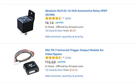

    @mesojdm pyridium audio wanted 60 for the module. Went down next door and got it for $21.99

    Correct. The one off my relay. Pretty sure it's 87 as well.
    To be clear the "yellow" is in the picture is just from my own harness, it's not one from the truck.
    At no point in this mod did I cut any wires in the truck, just tapped into them.

    Yeah, they are a rip but only place off the top of my head I knew was in stock. There are other flea-bag shops around that can be had for cheaper
