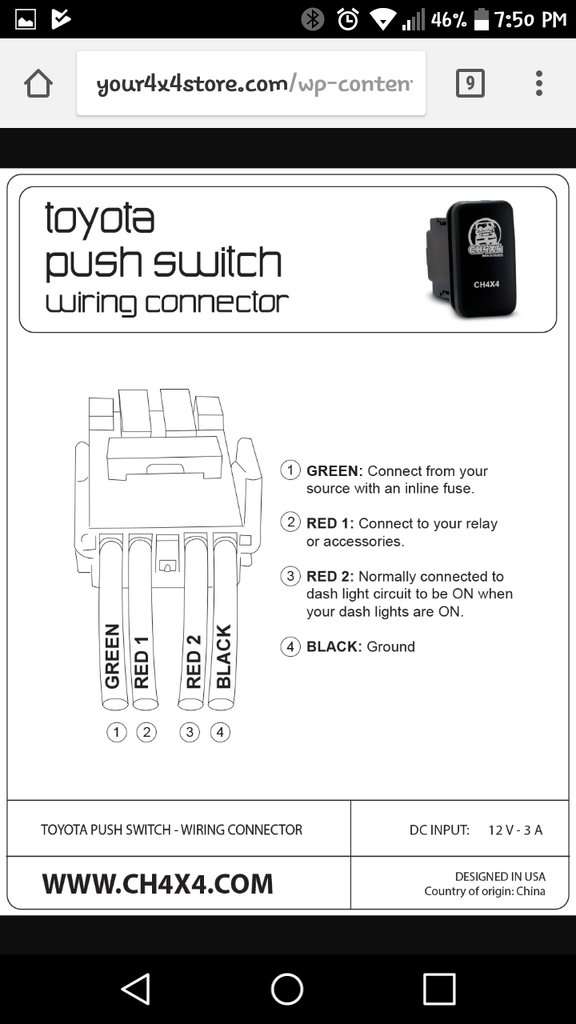

    Can the CH4x4 switch be used for the off and on mod? I want to have a switch that give a nice clean look. I see that it has 4 wires. How do I go about this?
  14. Aug 30, 2017 at 7:58 PM
    #214
    MESO
    MESO [OP] Major Modder Vendor
    Feb 16, 2015
    #148809
    16,292
    State of Jefferson
    2016 DCLB TRD HELLCAT SWAP
    Yeah. You would just take the power wire from the ECT mod and instead of going directly to the cig lighter(or fuse box whateever) it would run into the green wire, then the red out to power. If the CH4 button is not depressed, it will not allow power to go to ECT mod, and act like factory. If the CH button is pressed in(on) it would power the ECT on like normal operation.

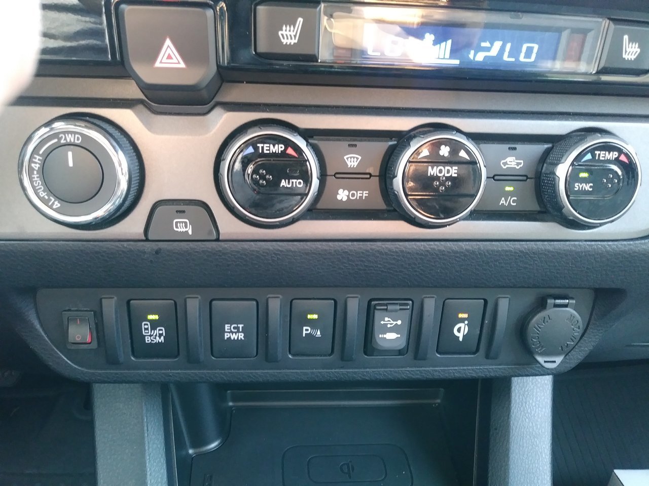

    Got the off/on switch installed. Thanks again to OP!

    @sig916 Looks awesome, that's exactly where I put mine. I like having the option to toggle on and off and it's been flawless.
    I find ECT On works better for pulling trailers and highway driving. (doesn't affect MPG much if at all and better throttle for towing).
    I find ECT off works better in city. (sometimes up to 2+ mpg more).
    If I plan to drive city that day I turn it off. Highway or towing? Flip it on. Crank it up and never think about it again. It's a bit cobbled, but I wanted the option to default it on or off and the switch is exactly that.
