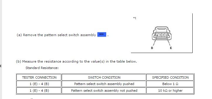

    Pretty sure you want terminals 1(White/Black) and 4(Pink) on a time delay.

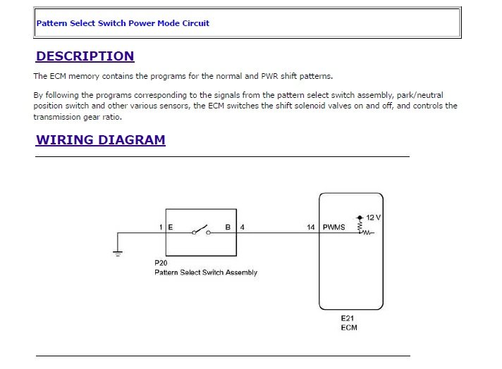

    Nice work! Did you install a diode (reverse biased) across the relay coil? If not, you'll be introducing a rather large and potentially damaging voltage spike (flyback) on the start signal pin every time the relay de-energizes. We've already seen how sensitive these trucks are to electrical changes from stock.
    Just a word of caution, not trying to piss in your cornflakes!
    Here's a link if anyone is interested..
    http://davidbridgen.com/coil diode.htm

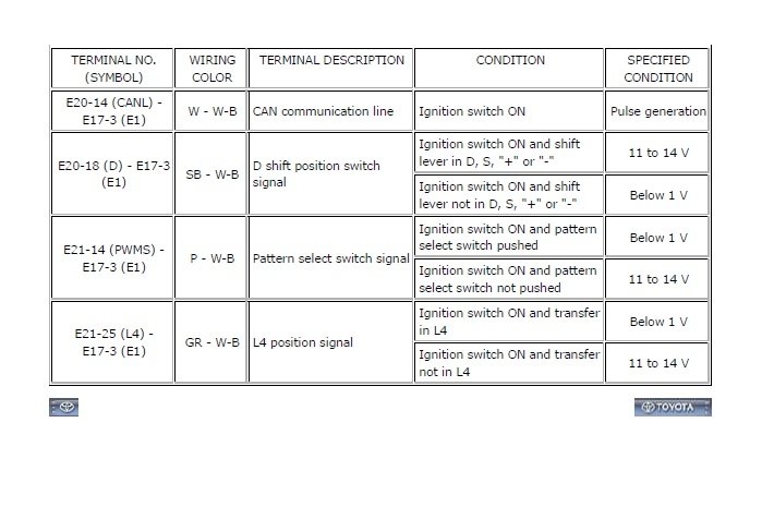

    What's weird is, the oem switch has ground on one side and 12V on the other.
    Maybe the switch has a relay or latch/unlatch function.:notsure:
    I wish I could find what terminals 2 & 3 are supposed to be. It's not in the transmission or lighting section of the service manual.

    Judging by the diagram you posted, it looks as though the +12V is supplied through a pull up resistor. So when you apply the ground through the switch, it just pulls the line low (not much current draw). I was actually surprised that the OP was able to draw enough current to energize the relay through the circuit. I'm not sure how much that micro-relay coil draws, but the relays I use on a regular basis draw approx. 200-300mA.

    So that's what that is?
    The foglight relay/switch is powered the same way. I haven't pursued the "anytime mod" further, cause I had no idea what was going with the 12V from the ECU.
