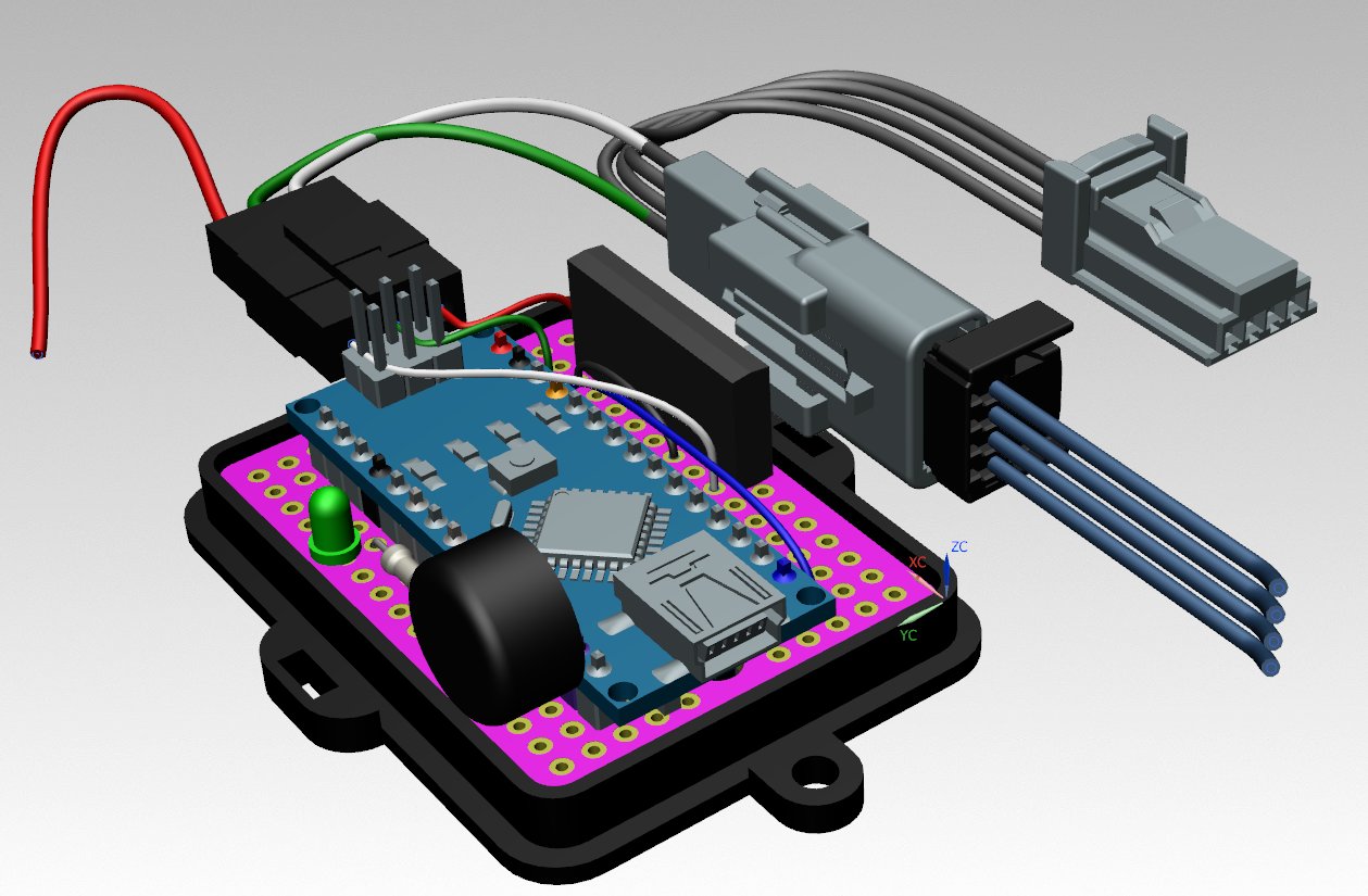

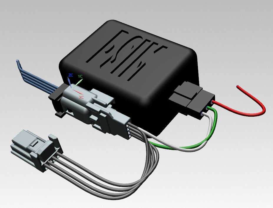

  14. Oct 22, 2018 at 8:41 AM
    #414
    DSIM
    DSIM Well-Known Member
    Feb 5, 2018
    #243518
    887
    Daniel
    Raleigh, NC
    2017 MGM Tacoma TRD Off-Road
    Mine is coming along. Just waiting on a few parts (Piezo and Relay).
    Chose to use the same Relay that @DaMaDo used to keep the footprint small and the solid state should be more reliable.
    Was able to use the same enclosure as my dome light module just cut down on the height a bit.

  17. Oct 22, 2018 at 6:07 PM

  19. Oct 22, 2018 at 6:11 PM
    #419
    DaMaDo
    DaMaDo Well-Known Member
    Aug 14, 2017
    #226790
    505
    Northern AL
    2018 White TRD Pro
    You using Siemens NX for CAD?
  20. Oct 22, 2018 at 6:14 PM
    #420
    DSIM
    Feb 5, 2018
    #243518
    887
    Daniel
    Raleigh, NC
    Yup how'd you know?
