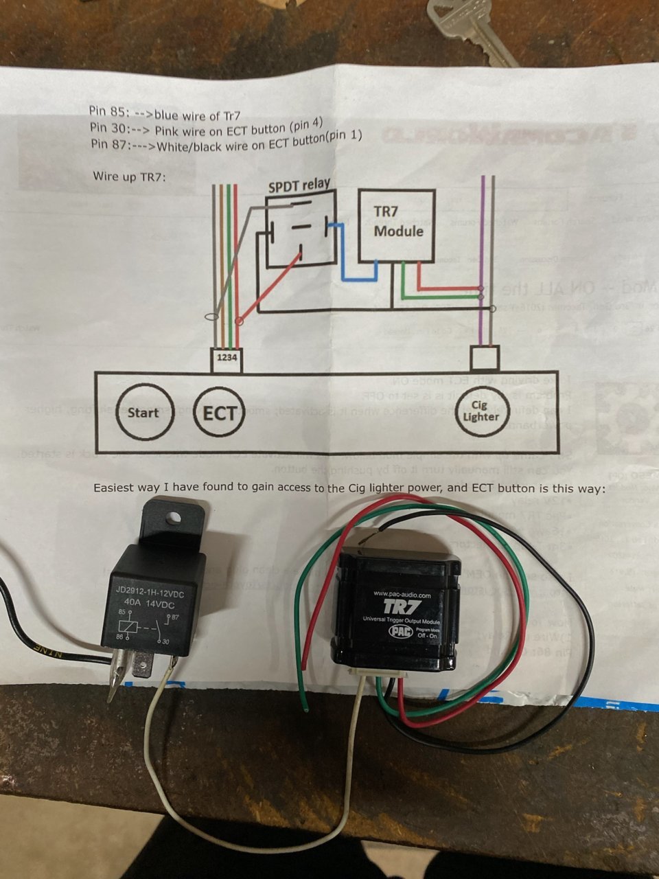

    Ok, I've had the older version of the first kit lying around and finally decided to install now after much reading and confusing posts I am asking will this work with the pictured components. Thanks for any help.

    Wire up TR7:
  18. Dec 21, 2023 at 8:10 AM
    #518
    Rudy217
    Rudy217 Member
    Oct 13, 2023
    #435377
    18
    Found i think better way to do it-no modules no relays .Just 2 wires and switch
    Pink wire #4 is a momentary ground signal to ECM.
    installed momentary switch under shifter cover on top of the shifter.Run ground from shifter base to switch and second wire tapped to pink #4.
    Switch mouted where N position is-every time shifting from P to D closes circuit and triggers ECT.Going back to R triggers it again -no ECT in R.
    ECT button still works like before mod.

    I saw the video on this. I have the old Messo mod. my issue with this is if you take your truck into the dealer for MX and they have to test drive it they may discover it. My mod i hold the ECT button down for 5 seconds and it disables the mod, which i did when i took my truck in for the coolant crossover pipe replacement.
    also the video points you you don't have to remove any of the dash bezels which takes less than a minute. This you have to remove the center consul. lastly it is constantly being switched on/off/on/off
    My take.
