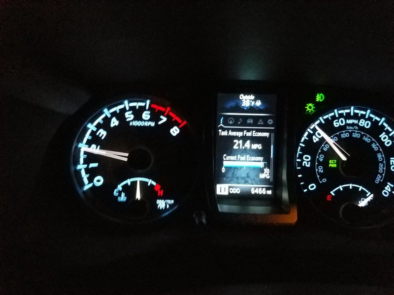

    I always have ECT on. Mileage is good. This is a 60 mile sample. 20170317_195820.jpg

    I spoke to the service manager about this. He said in order for them to meet mpg ratings, the Ext switch HAD to be a switch that was manually engaged by the driver every time it is used. It couldn't be automatic or else they wouldn't be able to post their mpg ratings that they do
