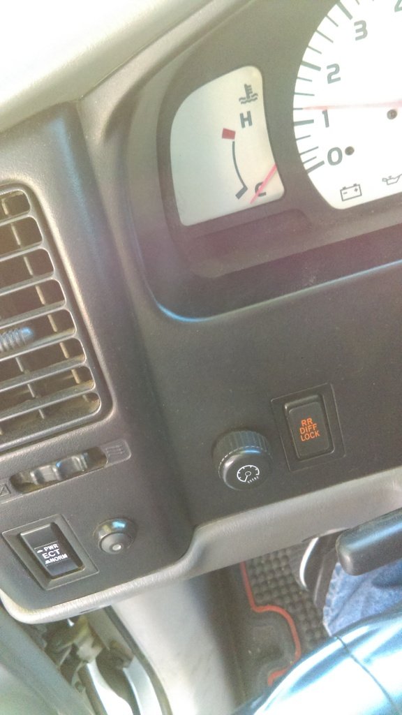

    I have an 01 I also have this ECT button.
    Is there suposed to be a light to indicate it is active?
    Do I push the button in before starting the truck to get it to activate?

    Have you tried posting in the 3rd gen section? Doubt you'll get the info you need here.
    Yes, there's an indicator on the lower right of the instrument cluster (from what I remember...I can double check later when I'm in my truck).
    You can turn it off/on at anytime. I just leave mine on...with it off, I can tell that the truck feels a little sluggish, specially when holding a gear just a tad longer makes all the difference).

    I pushed in the button and started my truck
    Nothing no light :-( I'll have to check the light bulb this weekend

    Jerry311SD, My 2003 ECT light is on the right side, under the fuel gauge, and next to the 4x4 light.
