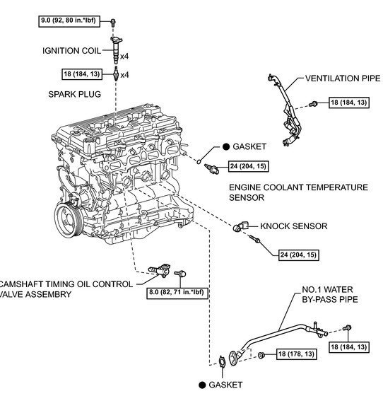

    Good evening. I have a major issue and can’t locate anywhere.
    I’m looking for the location of the ECT sensor on a 2006 Toyota Tacoma 2.7L I have looked on every form and all over web for hours and nothing. Any Information will help out!

    I have 2005 4 cylinder and can’t locate the coolant temp sensor

    It is located in the cylinder head on the drivers side behind/below the black plastic intake manifold
