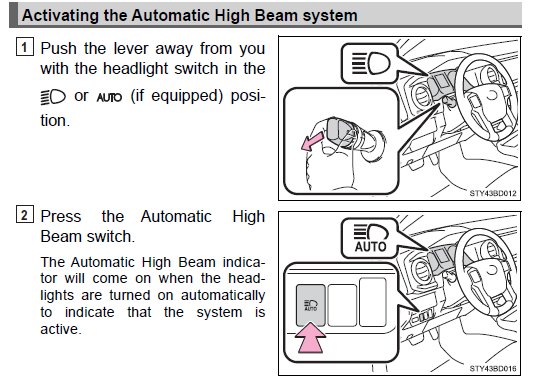

    Thanks for the writeup! I'd like to do this, so I can switch my Auto Headlight button shown here from the Meso knob. It's annoying to take my eyes off the road to find the Auto button. :annoyed: Any thoughts on how I'd make that work? I'd totally pay someone to make it plug and play (extension harness, purchase and wire to the PRC T27, plug into the Meso shift handle). :cookiemonster: Anyone?

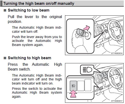

    I swear it feels like an on/off switch... Can anyone else confirm, please?
    I'd like to remove that switch altogether, to make room for my puddle pod switch (2-low mod is already going where the ect switch is). I'd still pay anyone for an Auto Highbeam switch relocation wire that's plug n play!. ;)

    After reading again the instructions to activate it, it does behave like an On-Off switch, so yes a TR7 would be needed inline with Meso's Stealth shift knob switches.
