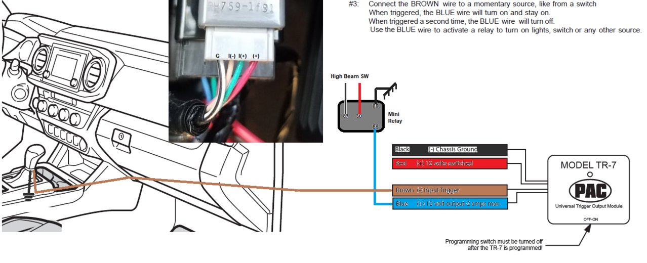

    So you cant run a hood scoop light from the right side ECT switch ? Without this pactr7?

    Correct, but it looks to be a pretty simple day project.

    I wouldnt think a day to get the TR7 setup haha. All you have to do is follow my video. Anyone can feel free to reach out to me if they have questions on how to do this setup.

    This is a good alternative to the TR7 if you guys are looking to turn the momentary signal from the stealth knob to a latched feed.
    http://www.wolstentech.com/products/latchingrelay/latchingrelay.php
    I've sold hundreds of these (not this exact model) with the heated mirror kits I build and can vouch for the quality. Easy to setup too. Anyhow don't want to sound like I'm selling the product lol, but it is a simple solution... not as feature rich as the TR7 though.

    Sounds good, but $19 for the TR7 & relay shipped to my door on Friday, vs $35.50 for the LR-P in 3-4 weeks. No thanks. :hattip:
