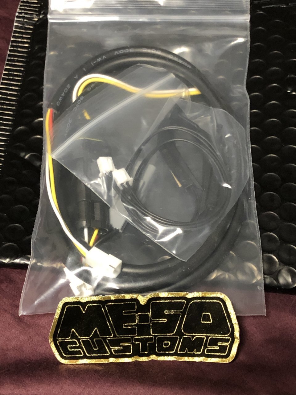

    Came home and this was waiting for me. Don’t know what I’m more excited about? The new upgraded DIY kit, or the new sticker that I don’t have!! Thanks again @MESO

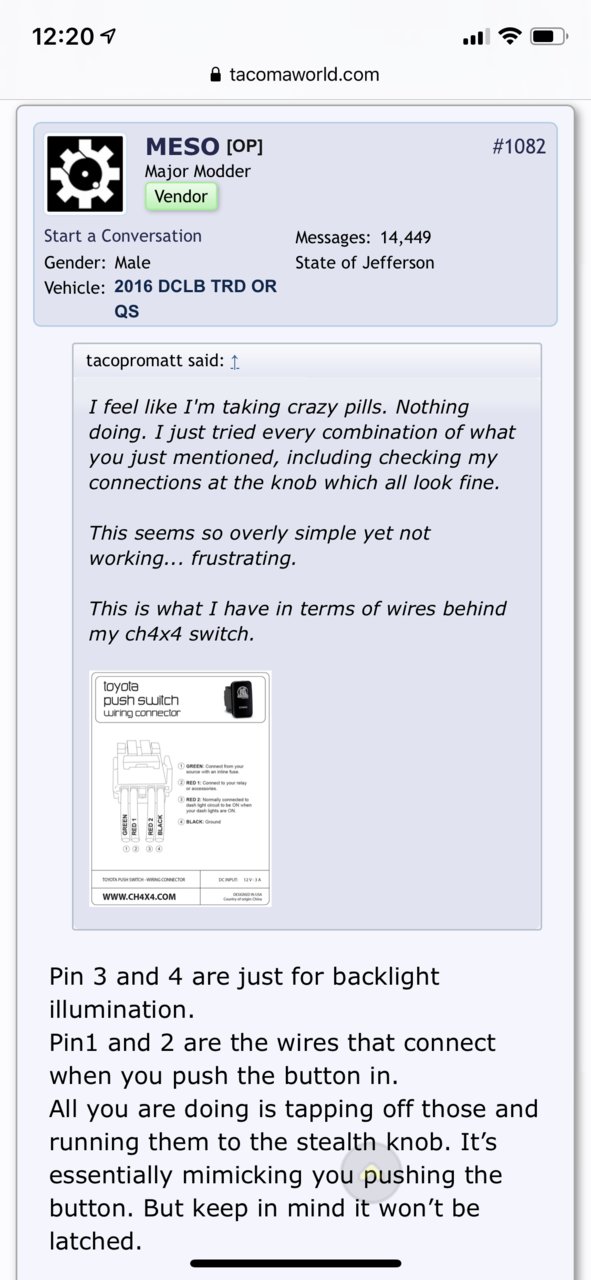

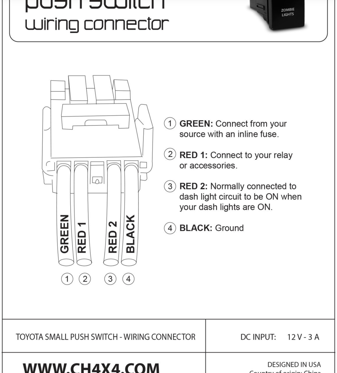

    Help me understand...when I splice pins 5 and 8 to stealth button...I press button once and release...Does the camera view stay on?

    Wiring help
    I have this switch for my front camera which wires do I tap the Stealth button into
    Thanks

    I thought it was red1 and black- but to confirm look back a few (maybe 10) pages and it’s mentioned

    I went back and looked but the button I saw only had 3 wires and went to the beat sonic adapter and I also saw the anytime camera button where it toggles but that button has 6 wires
    I was thinking it would be the green and red 1 wire but I wanted to make sure before I do it

    No MESO posted it- find his most recent post in this thread and hit the back arrow on that post and keep going back until you see him mention it

    Ok I think I found it but he’s talking about the Factory camera button on the 2020 but I guess I can try the same thing and try and use a jumper to see what wires work.

    Splicing the pins to the stealth button should function the same as the camera button already does. It's a momentary input by default, same as the stealth switch.
