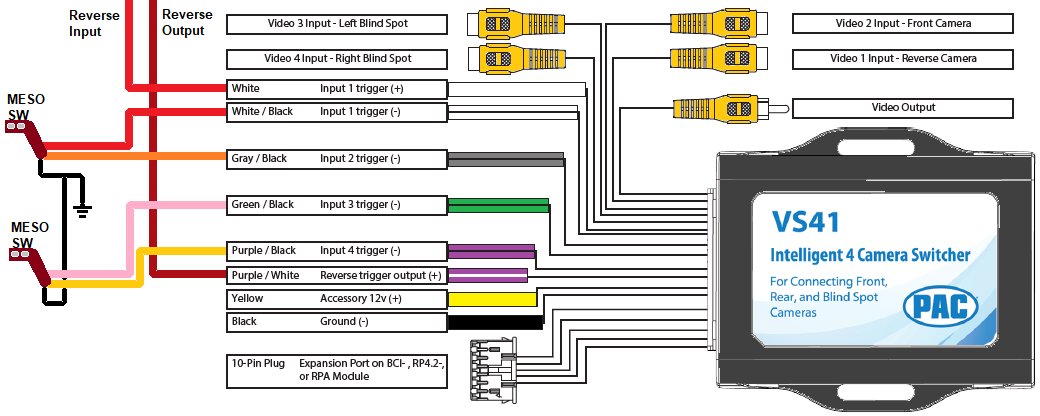

    That would work well. I was thinking of a single switch solution with 4 cameras. I looked up the cost of a 12V AND gate and they run a whole $0.73 in singles.

    Hmm, would we be able to adapt this so that we use 3 cameras, (front, back, cargo) while only using a single switch trigger?

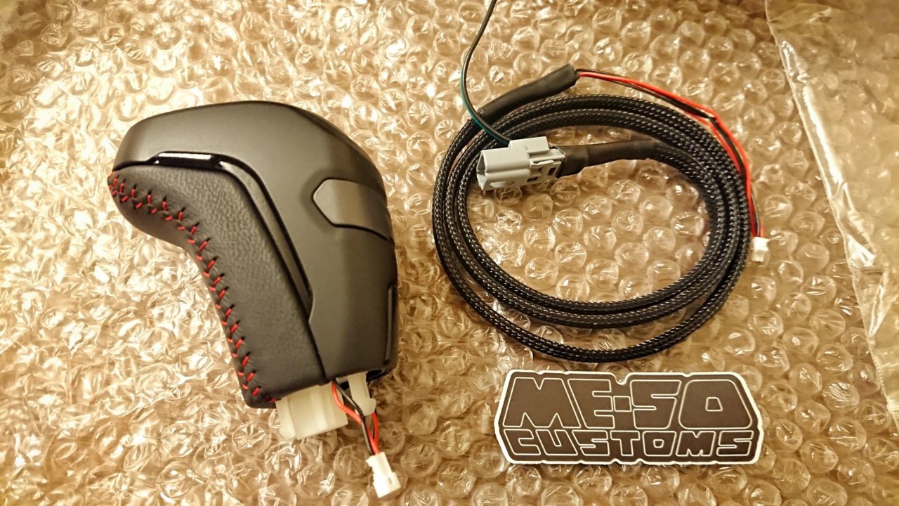

    What’s the difference between the V1 and V2?

    V2 has molded plastic parts vs printed. Smoother edges. Also has longer plug leads on shifter end for easier install.

    How do you know which version you have? I just purchased some last week

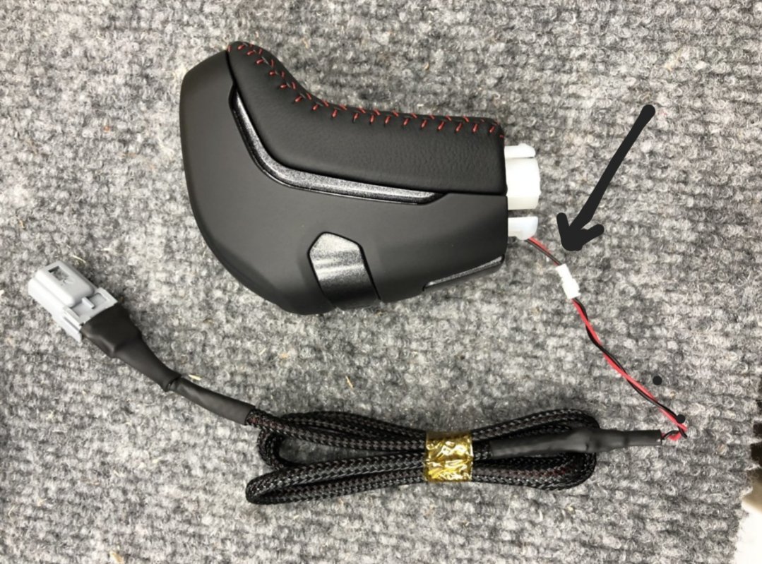

    The wiring harness or the molded switches. Look at the 1st post for pictures of the original

    V1=Red and black(short) wires coming off the stealth switches
    V2=all black(long) wires coming off the switches.
    Nothing wrong with the old version, the new one is just refined and polished:)

    V1 has very short leads to the connection as seen here.
