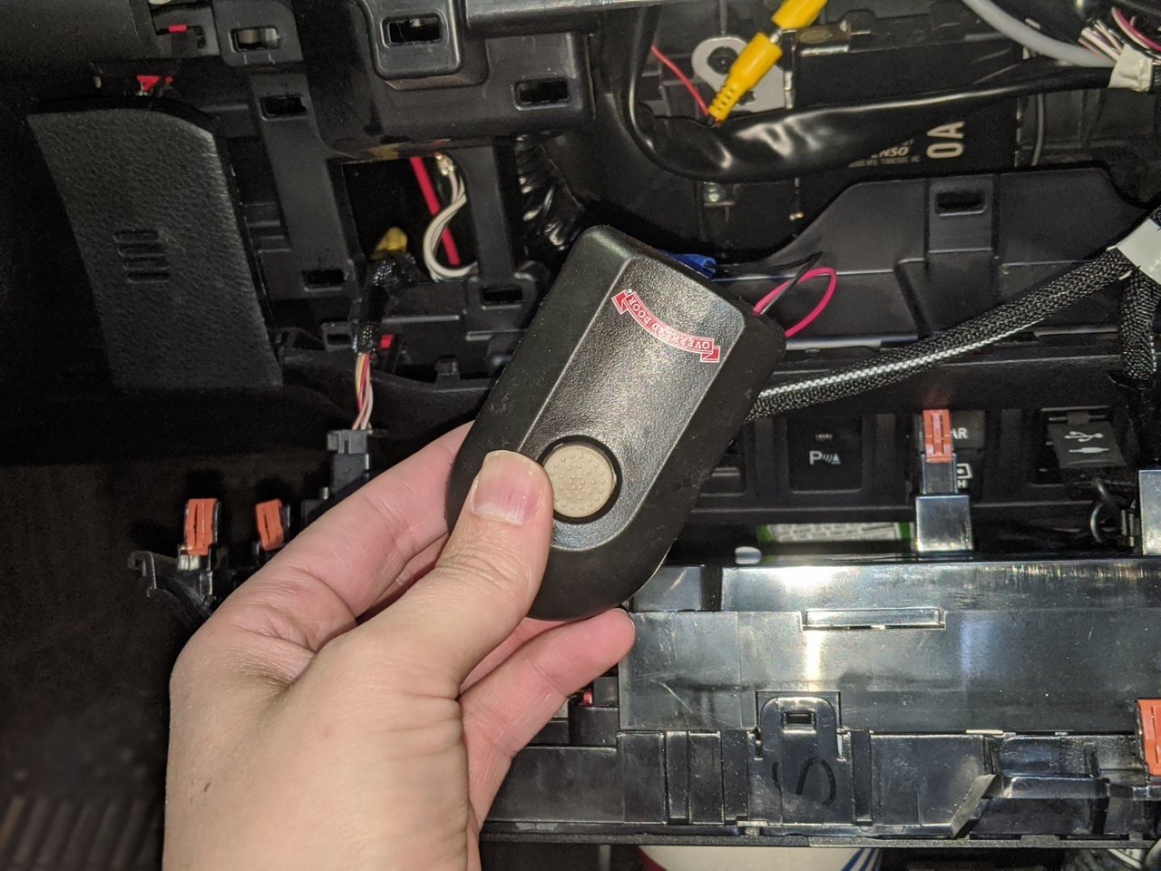

    Thanks, yeah... I was just wanting to see your solder job. It's cool. I plan to do the same thing except solder in a 12V => 3V converter so I don't ever have to worry about changing batteries.

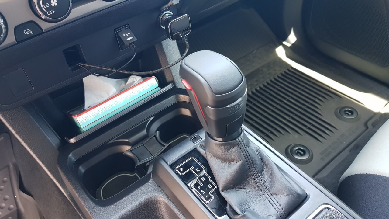

    Finally installed mine today, took my time and I noticed that I was having a hell of a time getting the parking brake boot off, I noticed that is was just clipped in place by slots. I popped it off the console and drilled out the rear of the shift boot clip with a 5/16" drill bit. This was where I was hoping the drill wouldn't eat up the shift boot.
    MESO's install video was a great help. I also had a little bit of hard time trying to feed the harness behind the climate control panel, I used a piece of long cable tie and taped it to the harness ends and fed it through the bottom. Installed and loving the convenience of having ECT on the fly. I don't have a use for the second button yet but hope to in the future. I also ran my phone charge cable and AUX cable, I'm going to notch a blank switch cover and use it tidy it up a bit.
    Thanks for the great mod MESO and thanks to all who contributed to it.

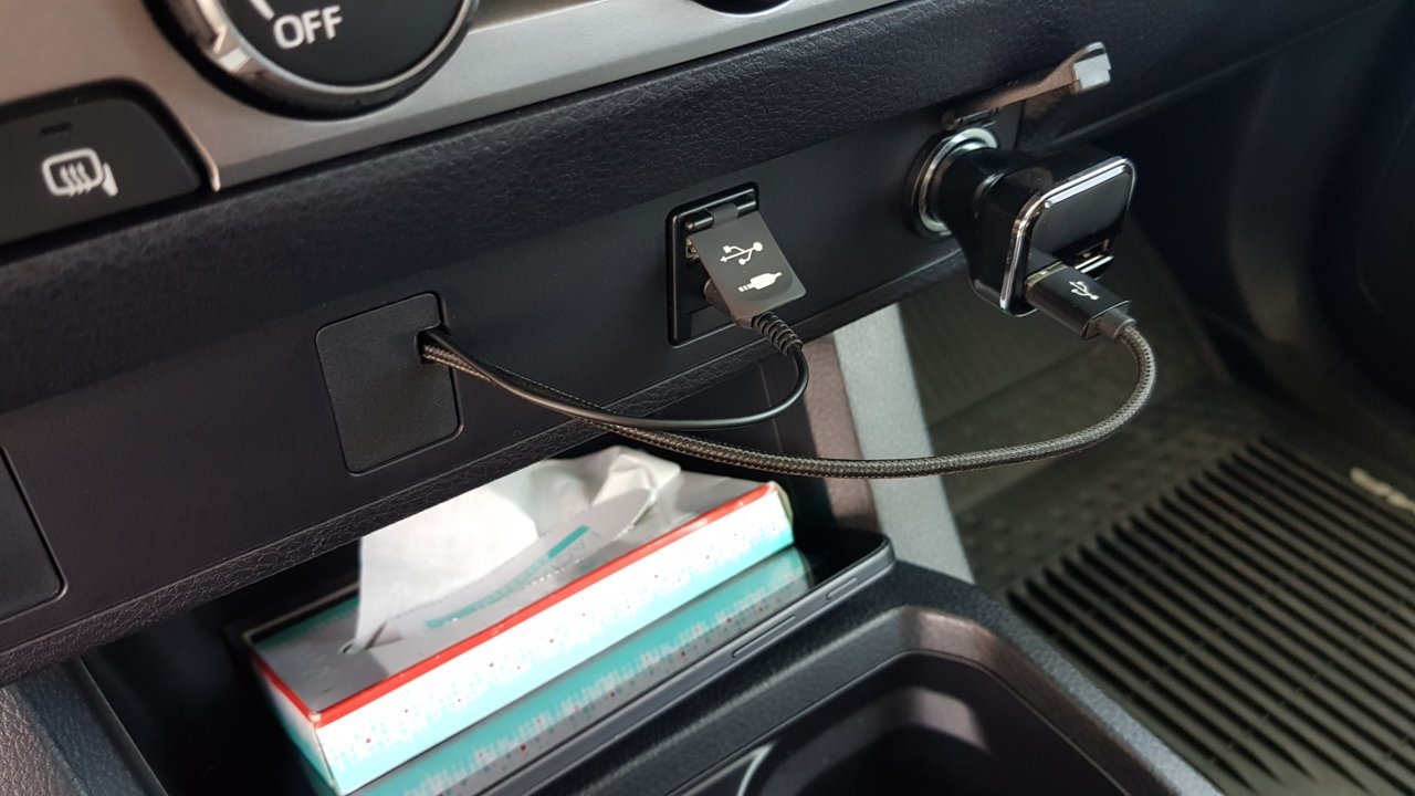

    Added the blank switch cover with the notch to cover up the hole. I forgot to add one more power cable for the tablet I plan to install but that can come later. Thanks to VicNic3 for the blank cover.

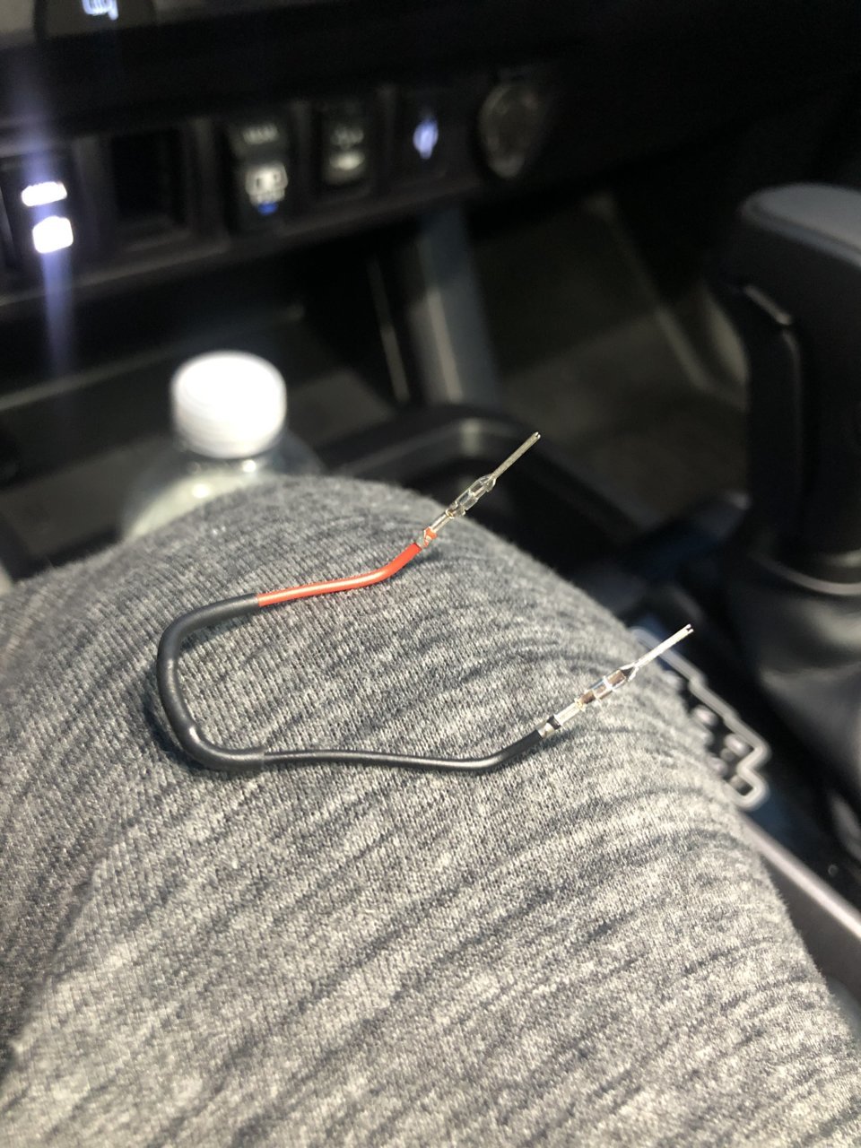

    so I finally pulled the dash off again so I could pop that camera switch out and test with the jumper wire. It works but we had the wrong wires! It’s red and green. So I tested with the jumper (it worked) then removed and tested the switch and it still works. In fact I can cycle through both front cam to rear to off and back again without holding down the shifter switch is my guess based on each tap of the jumper cycled through
    My jumper I ended up making after trying a paper clip and just regular wire with no success (but come to find out I was jumping the wrong wires- red and black)
    So hooking up the me-so 2nd switch wires (yellow and white) to the camera wires (red and green) does it matter which wire to which?

    So red provides power, black is ground for the switch illumination, and the green is the switch providing power to the module to switch. (pulse and not latching)
    The switch does not stay depressed...as the shift switch imitates also...

    Yea I noticed jumping red and black would illuminate the switch itself but that was it. So it wouldn’t matter which wire I tap yellow or white from the Meso switch right? (It’s just completing the circuit)

    Nope...but they need to be the same side knob switch,you'll be using both ends and back to the red n green at the switch harness.
