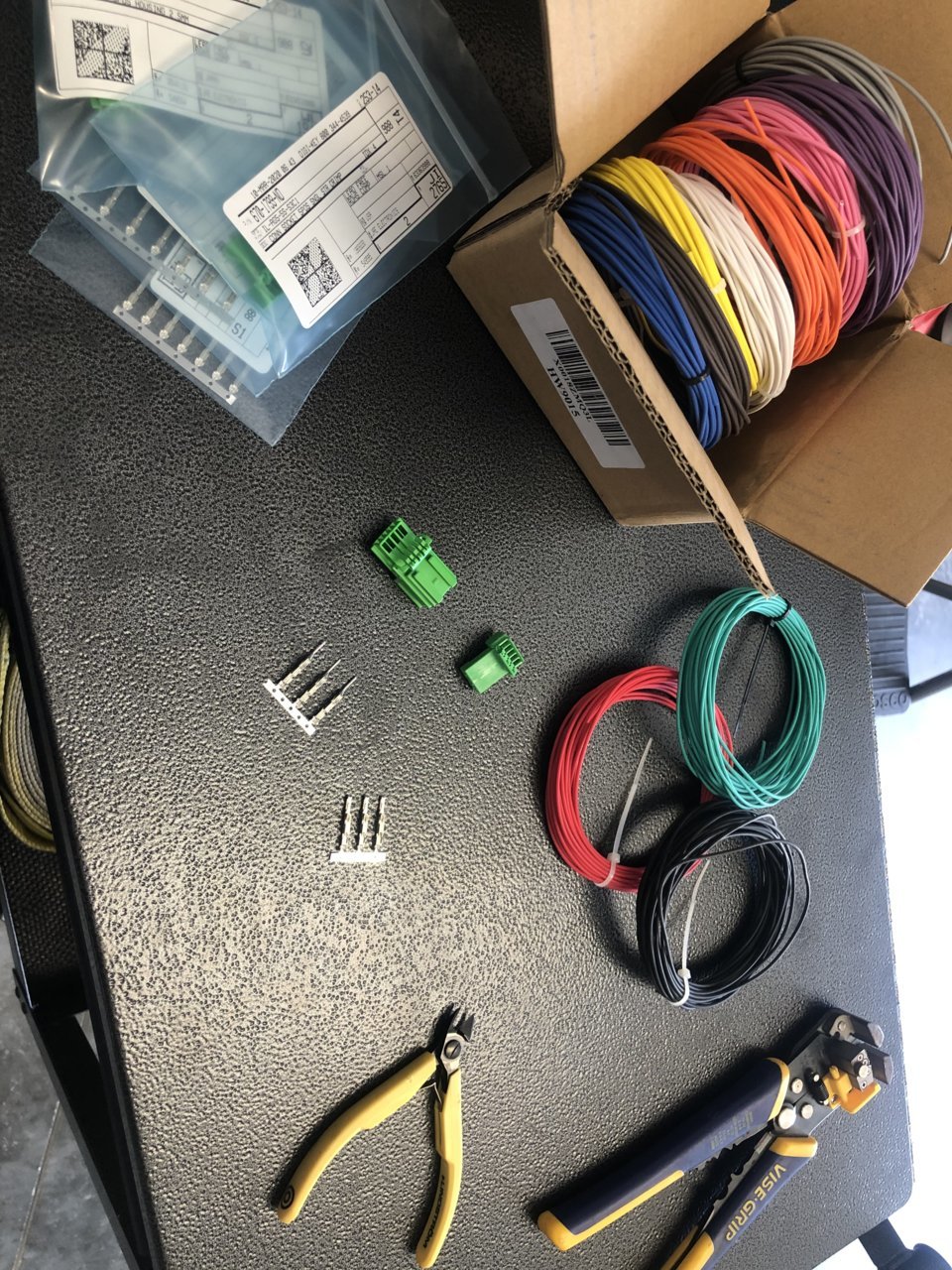

    Thanks for sourcing the connectors. Just got my txl 20g (I don’t do a lot of wiring so I bought a 25’ ea multi colored pack from wire barn) I also assumed the wire was 20, definitely not 18

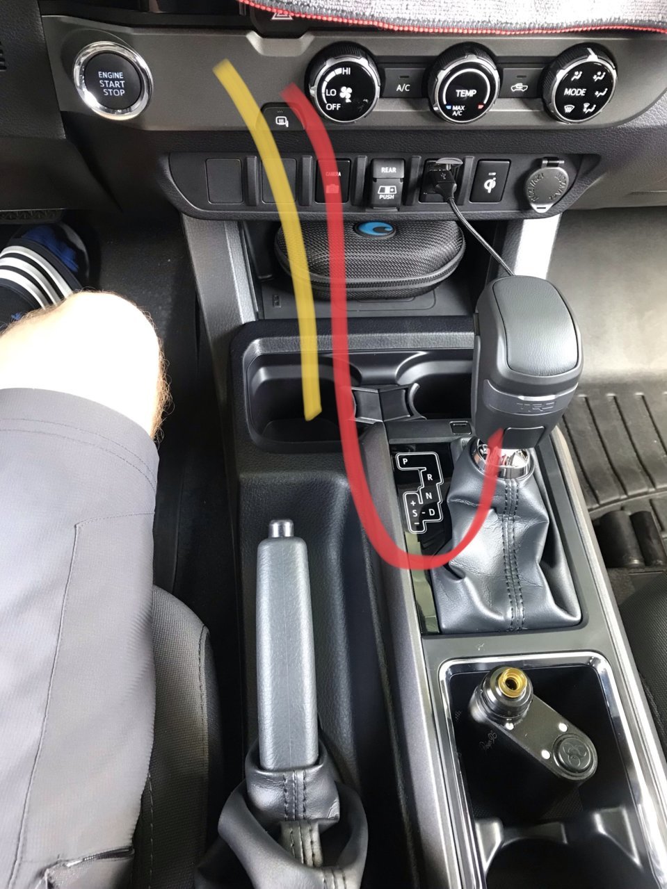

    Has anyone experienced any of their wires “catching” or getting snagged when they shift? A lot of sharp edges under the boot. Just wondering.

    Not if you route it correctly- to the left of the shifter.

    Any specific way. Or just route it to the left?

    I have a post in here maybe 1/2 way of this thread that shows how I routed it (pictures) and there was another that posted a picture that they actually drilled a hole to take a Christmas tree pin/zip tie on the left back corner of the shifter box.

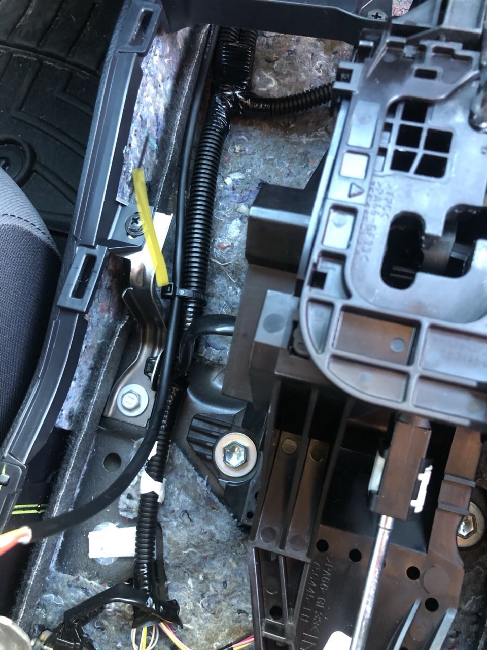

    I followed the factory harness (the yellow line) zip tied in 2-3 spots. The shifter harness is the red line.
    You can kinda see the end comes out near the back left corner8D8F5656-1C65-4D38-BC68-48BE06F957FE.jpg

    No special pin crimper so I used needle nose pliers. The 2 pins that I doubled up I also soldered to secure. soldered those wires to Meso’s pigtail E07F4A98-9EAD-4B35-9AAE-DFE4D1CD766B.jpg
