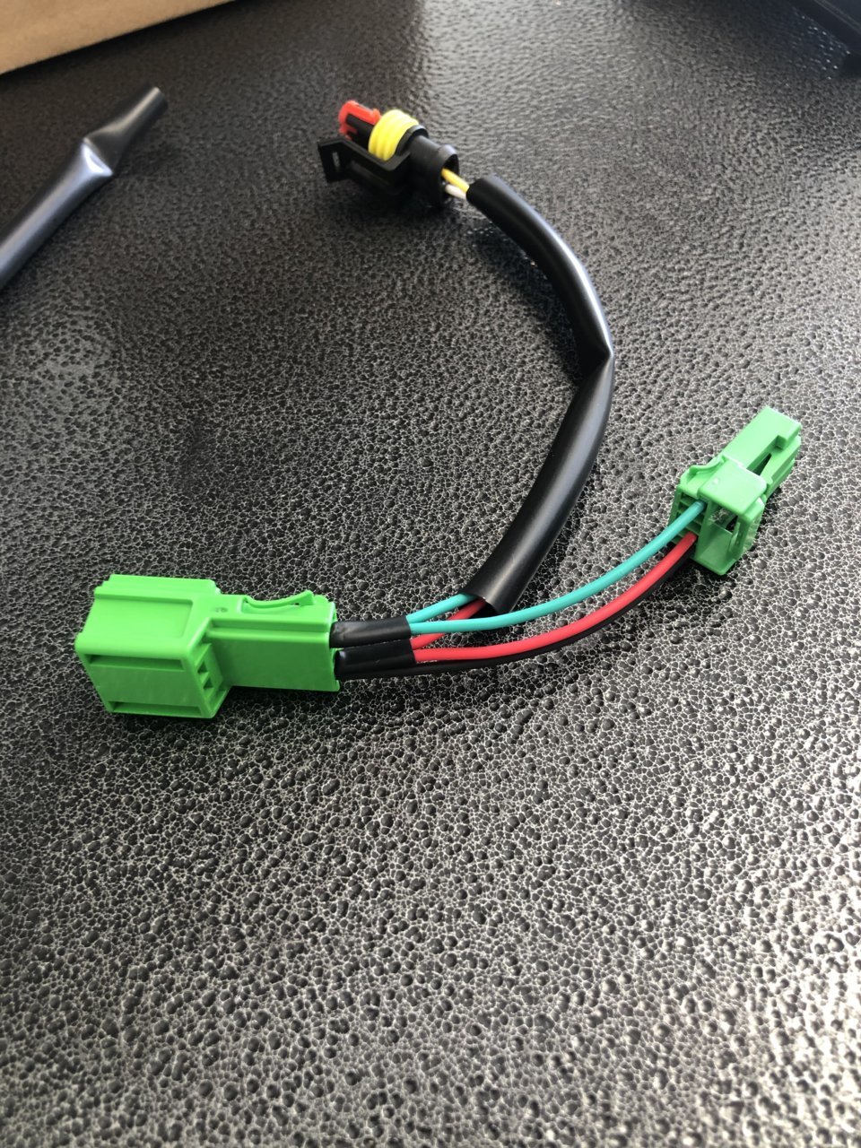

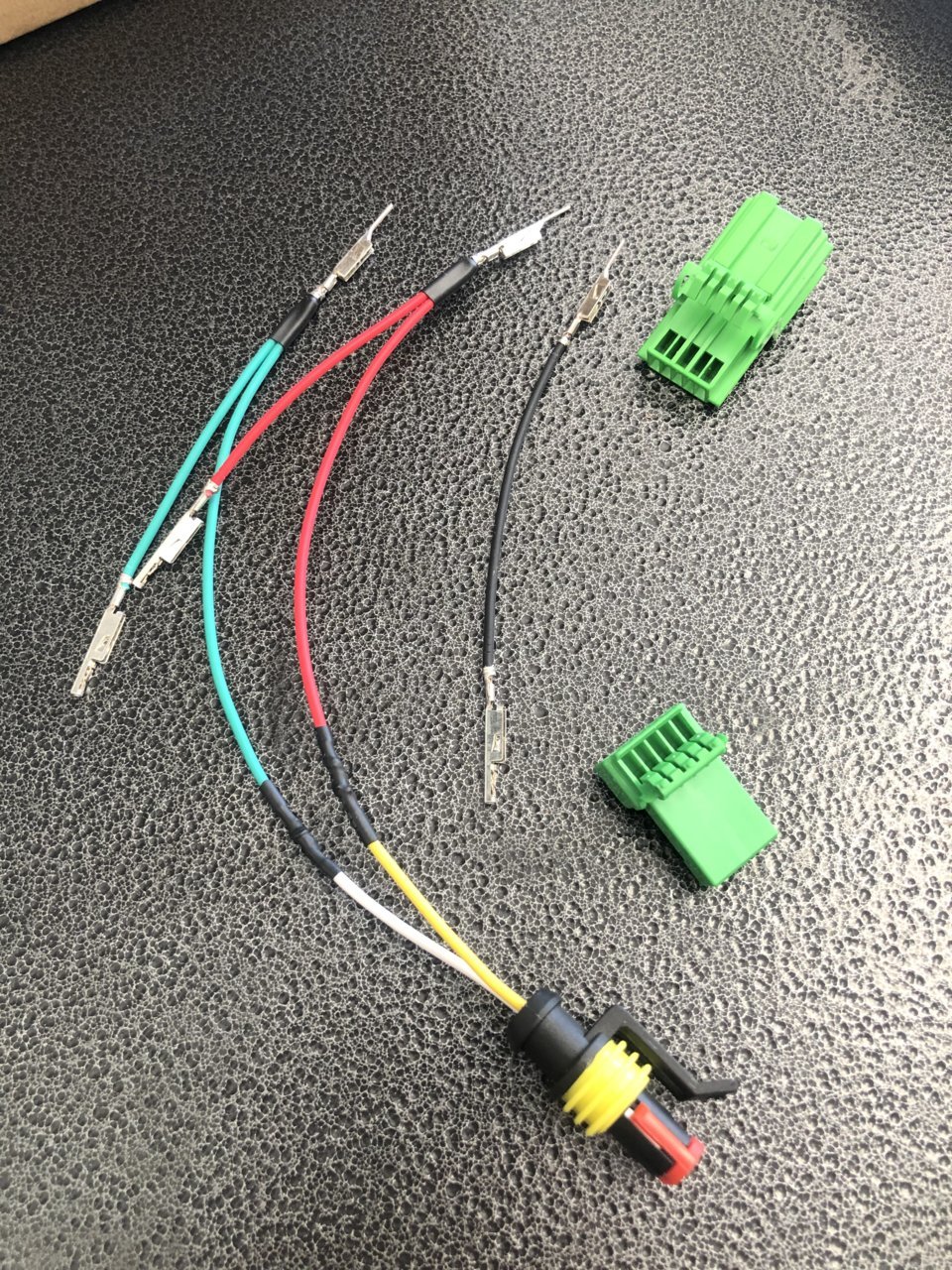

    I’m not quite sure if this is what you guys were wanting (add this to the posts I’ve already made) this is more on the pins and sockets without a proper crimper.
    after looking at my add on harness, I wish I did a couple things differently (nothing wrong with it functionally just My ocd) mainly I wished I matched the white/yellow from Meso’s connector instead of red/green and then was thinking I can de pin Meso’s connector to eliminate the solder connection (still need to do this part)
    so I decided to take a few pictures of the process I took for the pins/sockets. Take note of the stripped wire and insulation in relation to the pin (or socket) 5E2200CC-01A5-4EA5-B1CE-B1A1197C814D.jpg
    Then make the 1st bend over the insulation 5406E160-882A-4700-9DE9-EBEEF5D51C1C.jpg
    follow up with the 2nd bend over the insulation. Then repeat over the bare wire. Be careful with the needle nose pliers to not damage the terminal but at the same time crimp it so it’s secured (overlap the tangs). F778517B-7088-4071-A7DB-CD536665A1AD.jpg
    For the doubled up wires you have to strip more wire where you’d originally want insulation (in order to fit). I placed the wires on top of each other rather than side by side in order to fit into the connector.25B39449-6380-4F7B-9438-9B1634209CAB.jpg
    because I wanted to make sure 1 of the wires didn’t pull out I soldered these. 8A6FEC90-D173-463B-B30B-705DCDBD698D.jpg
    I then added heatshrink on the double wires (not sure it’s really needed but I felt better about it since I couldn’t crimp onto the insulation and didn’t want a weak point with possibly bending and breaking the wires over time). Don’t cover the pin/socket though so it fits into the connector. 74E2FC3B-3BE9-45EF-9D93-D62155DECE68.jpg
