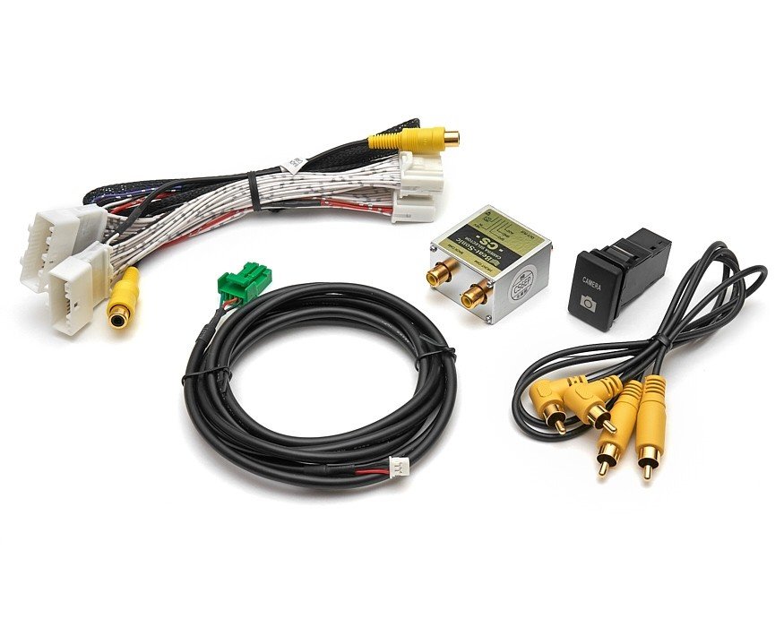

    Icon Coilovers & UCA's, Maxtrac 4" lift Spindles, Falken MT 285/70/17 Tires, Mickey Thompson Classic III Wheels 17X9 -12mm 4.53in Backspace, Bilstein 5160 Rear Shocks, TRD Cold Air Intake, Aries Action Trac Side Steps, Rough Country Speedometer Calibrator, Shift Sense Pro, Pedal Commander, Bakflip MX4 Bed Cover, Mountain Hatch Tailgate Insert, TRD Pro Grill, Start-X Remote Start, Pop n" Lock Tailgate, OEM Bed Mat, OEM Cargo Divider, OEM Bed Step, MORIMOTO 5500 35W HID's, ORACLE H11 - VSeries LED Highbeams, MESO Stealth Pro Shift Knob, MESO Puddle Pods, MESO Ultimate Turn Signals, MESO Total Tail Stage 1, MESO TRD Blk Start Button &Trim Ring &Coin Tray & Gasshole, Hondo Phone Mount, Clazzio Leather Seats, Vantrue Dash Cam, Off Grid/Blue Sea Fuse Block & Tray Mount, Beat-Sonic CS6EP W/ Natika Front Camera, Kicker Speakers/Subaru Tweeters & 300W Amp & 8"Hideaway Subwoofer, CADDY Train Horns, Redline Hood Struts, Automatic ECT PWR Power Mode Default Always ON, RAV4 Blind Spot Mirrors, Matt Gecko LED hood light engine kit, SEVENS Tailgate Letter Inserts, Smittybilt 2781 5.65CFM Air Compressor, AVS Window Visors, All Window Tint, RHINO USA Recovery Accessories, KTJO4X4 DRIVER'S SIDE GRAB HANDLE (Installed), DARTH VADER, & a STORM TROOPER, etc...
    If you are using this Beat Sonic setup, The Black Cable with the Green Plug end goes to the Switch...The White end goes to the RCA Splitter Box
    Either Tap/splice one set of the Shift Knob switch wires to this cable, or just eliminate the switch all together, and tie this straight to the Shift Knob set.

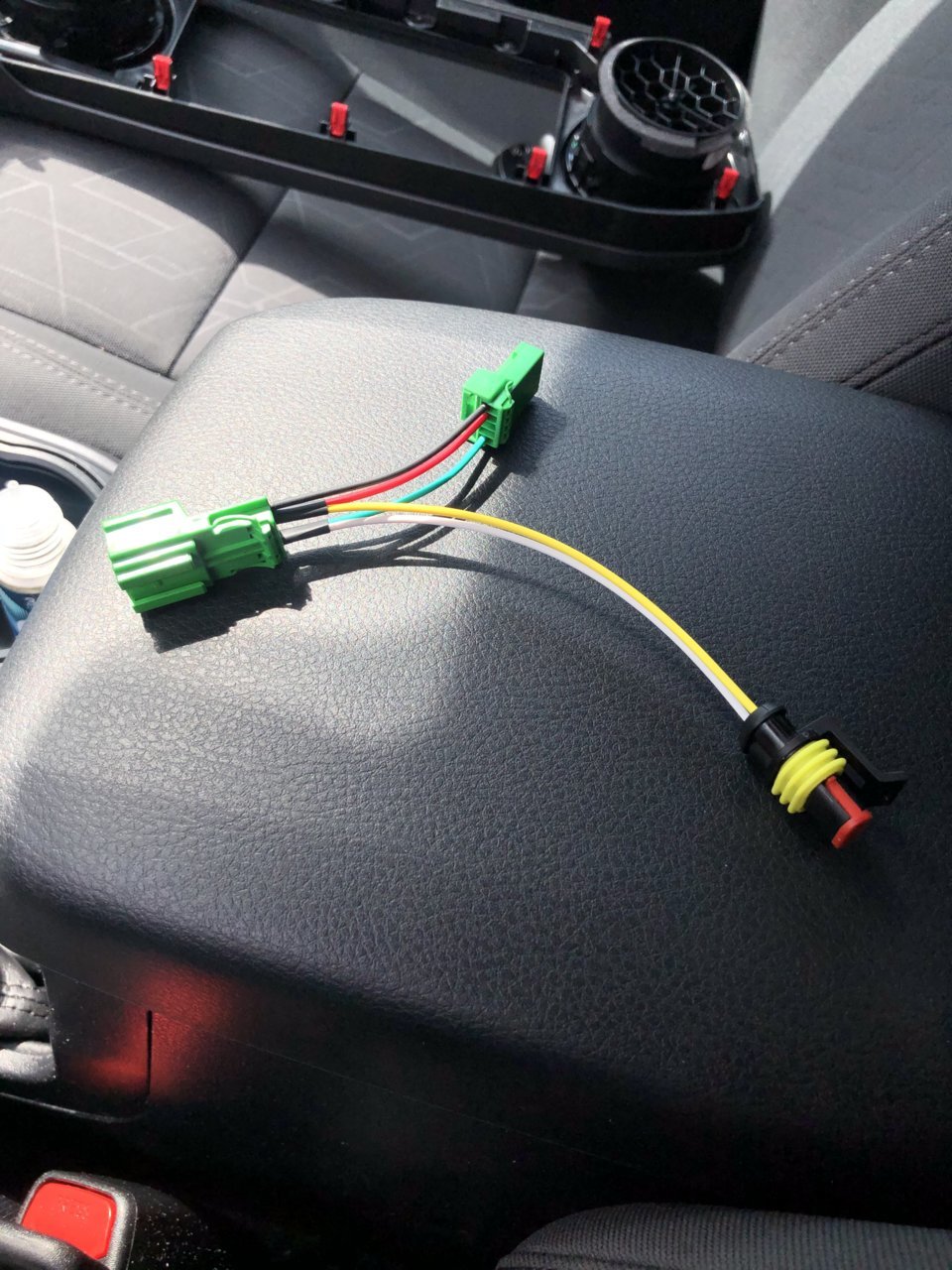

    I made a plug and play jumper harness. New harness plugs into that green connector in your post then other end into the switch (to maintain camera setting functionality) and then the plug to connect to 2nd switch. No tapping any wires!

    NICE! I Like it alooot! I Just cut the plug, and spliced straight to the shifter, And freeing up 2 Switch spots...(Camera & ECT)

    I’ve been trying to plug and play all my wiring mods (it does take more time because of getting the right/additional parts) but in the end it’s clean and can be easily removed for whatever reason.
    I thought about removing the stock cam switch but that’s how you can tell what setting mode your in (because of the led flashes) so for now it’s still in the dash but when I need the spot for another switch I’ll just push it behind the dash. You can still get to the setting mode with the shifter switch, you just won’t know where in the settings you are without the led (trial n error I guess)

    Here's the wiring ahead of the relay for the anytimebackupcamera system. Sounds like 58electricman and baldbeardedtaco have the beat sonic front/anytime camera system and is wired differently. I also think those with the 2020 factory front and back camera systems have figured out a way to make it work, just doesn't apply to me.
