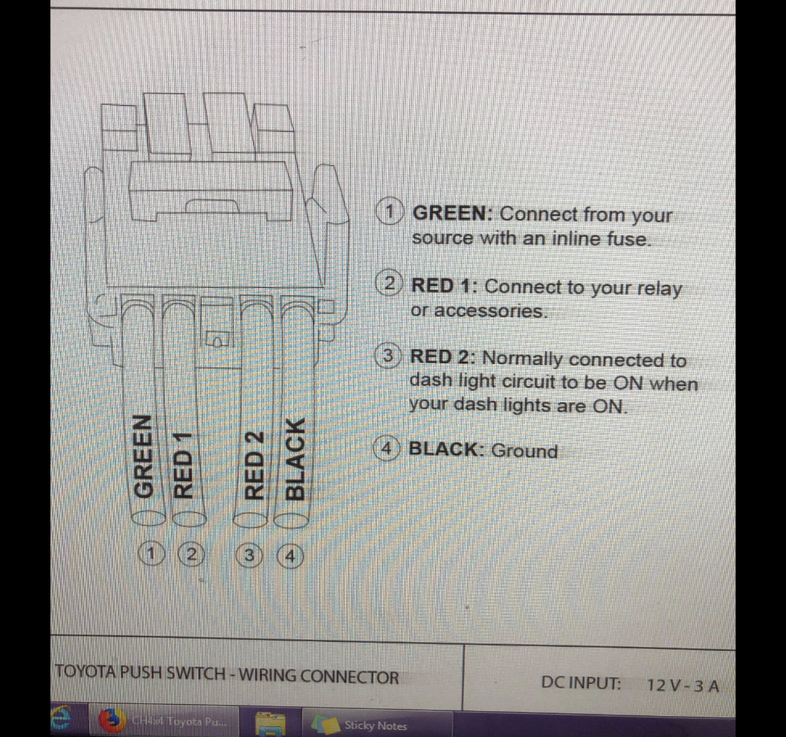

    I currently have ditch lights install on my truck and I have an oem style switch for the ditch light on the left side of my steering wheel. What do I need to do so that I can elimate the oem style switch and tie the ditch light to the right side of my MESO shift knob button? I rarely use my ditch light for anything else besides flashing people so my goal is to turn it into another "high beam" to flash people.

    I got mines hooked up to my scoop light bar. Just so long you have a relay you shouldnt have any problems using the shift knob switch as your ditch light switch.

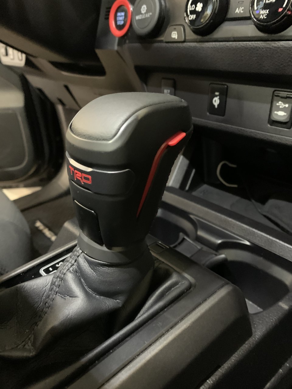

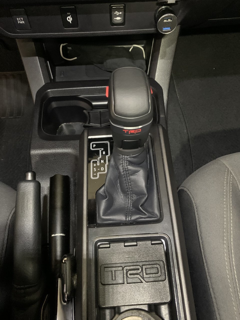

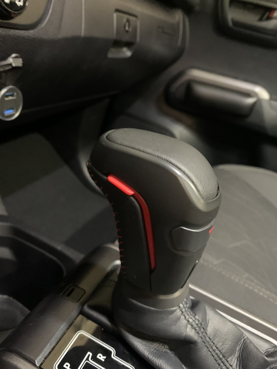

    Finally got my stage 2 all hooked up.
    -ECT on the left.
    -Light bar on the right.
    For the light bar, I ran two wires to the back of my regular light bar switch and tapped into the power going to the relay. When I press the right shifter button, it’s a momentary switch (on till I let go). The regular light bar switch still works as usual.
    3FFF4ADC-DBC2-4922-A369-704233E7E997.jpg 6E54E965-EB59-43A8-BF02-5C3F37648E2D.jpg 17FC88BE-CF80-4BDE-9889-67F77A5D338C.jpg

    I tapped the green and red 1.
