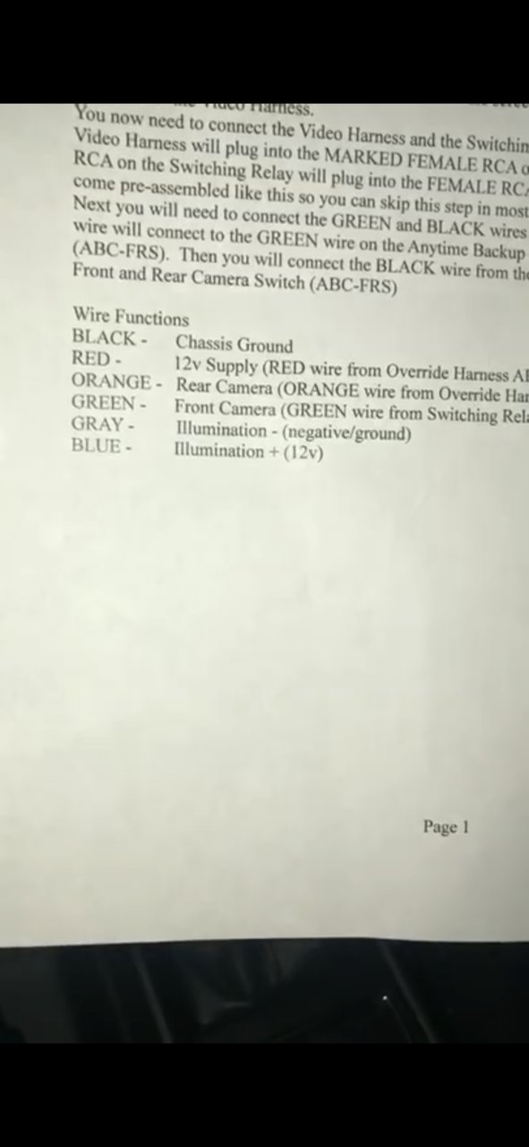

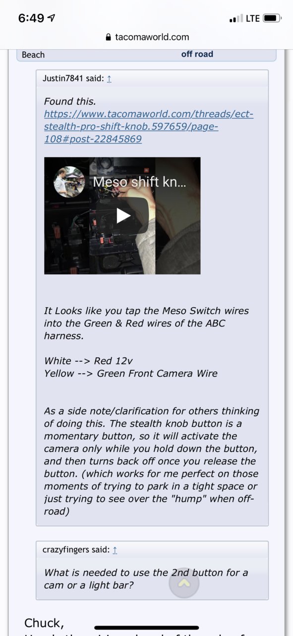

    Found it! For anyone interested, here you go.
    white from stealth pro to red from ABC
    yellow from stealth pro to green from ABC
    https://m.youtube.com/watch?v=bRVlJMvPyo4&feature=emb_title
    also, here’s a screenshot of the wiring the guy in the video mentions. Not sure how reliable it is but it’s a starting point.

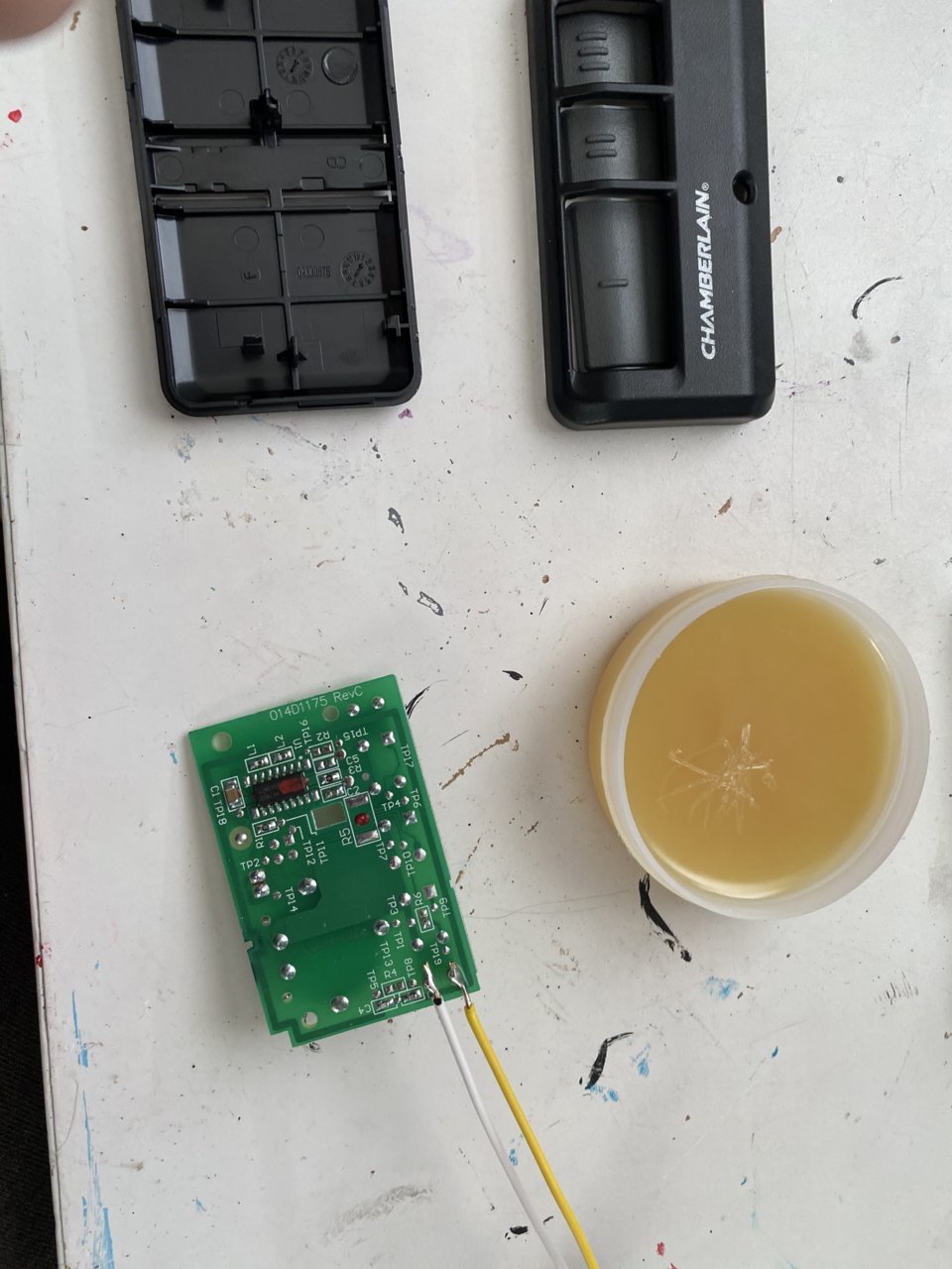

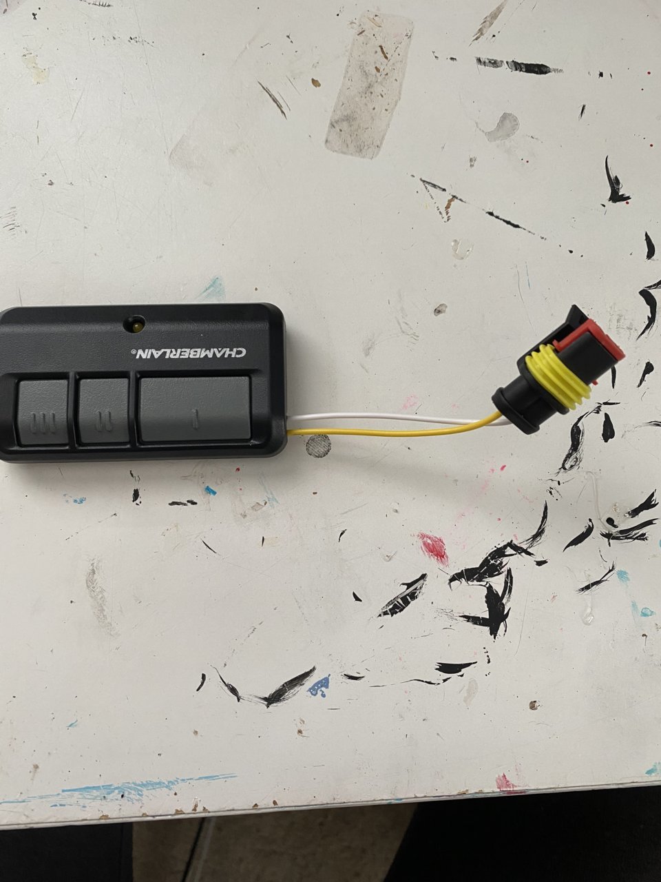

    Can also use it for garage door opener
