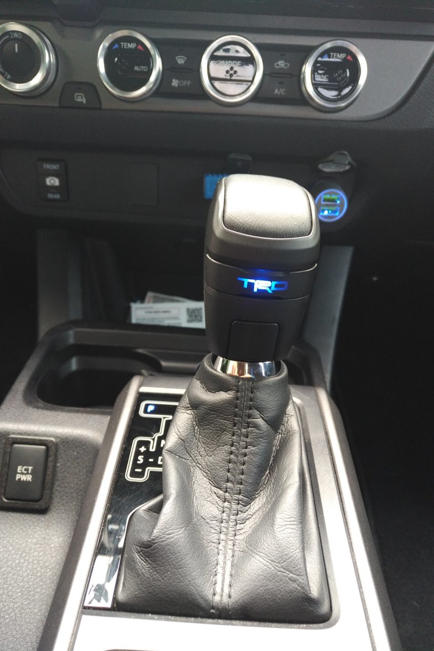

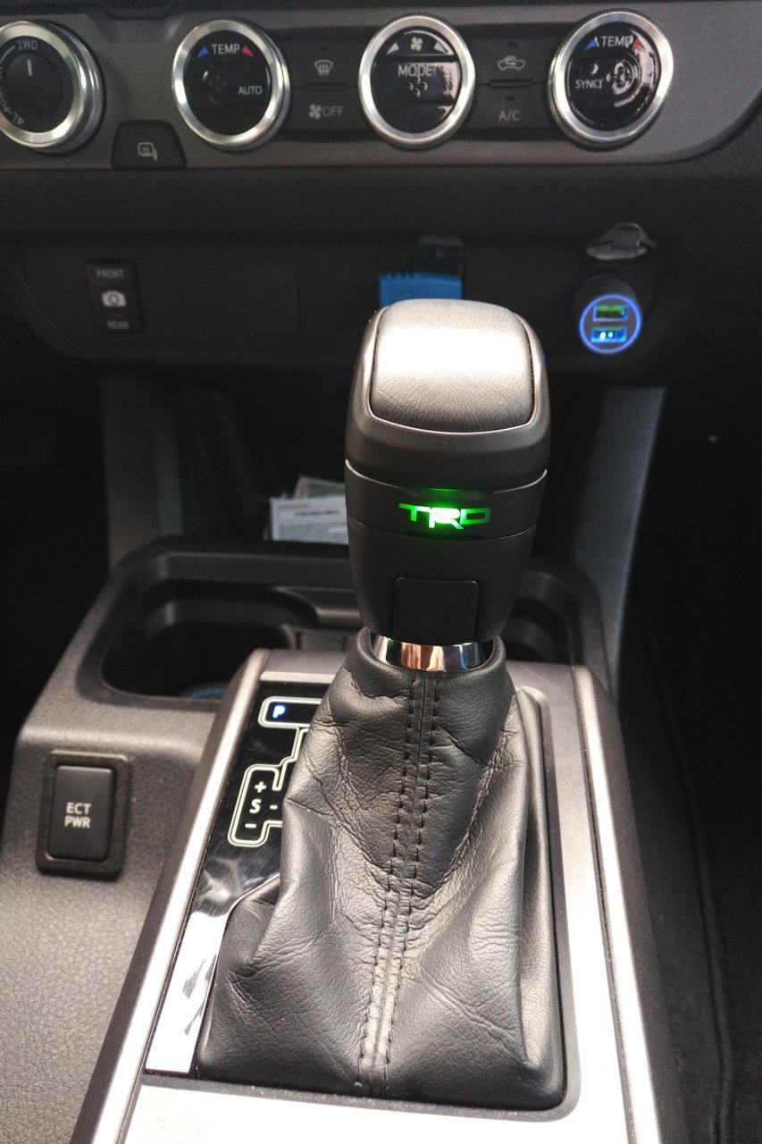

    If you want to use the momentary switch to power your light bar you could integrate a bistable latching relay.
    I used one to get a signal from the ECT button in order to switch the LED in my shift knob from blue to green when the ECT button is pressed.

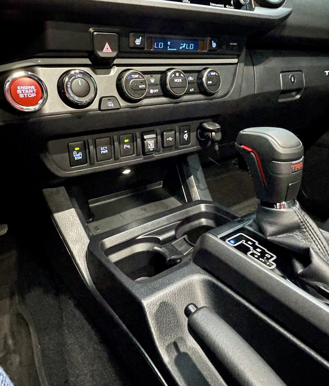

    Installed the MESO DIY Stealth Shift knob kit. Only installed one switch on the drivers side and saved the 2nd one as a spare. It’s great to have the ECT switch on the shifter. I also wired it so that the OEM ECT button still functions as normal. 71461034-0EE3-4580-BE1B-9355835C00D3.jpg

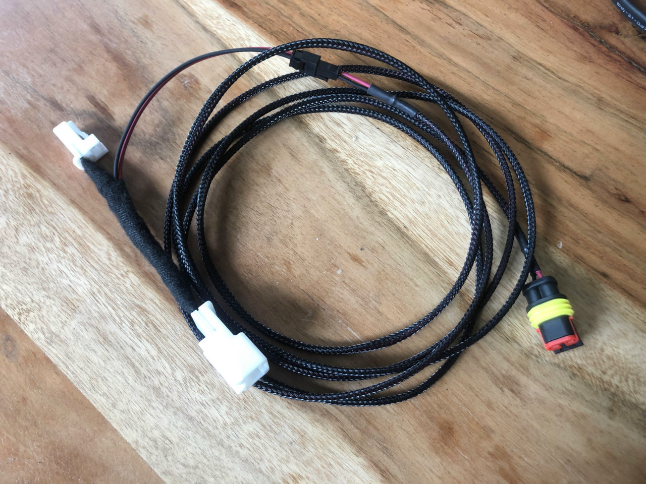

    I had a customer ask to retain the switch and then add an additional controller to the shift knob, but yeah if you wanted to delete it you could just use the male.
