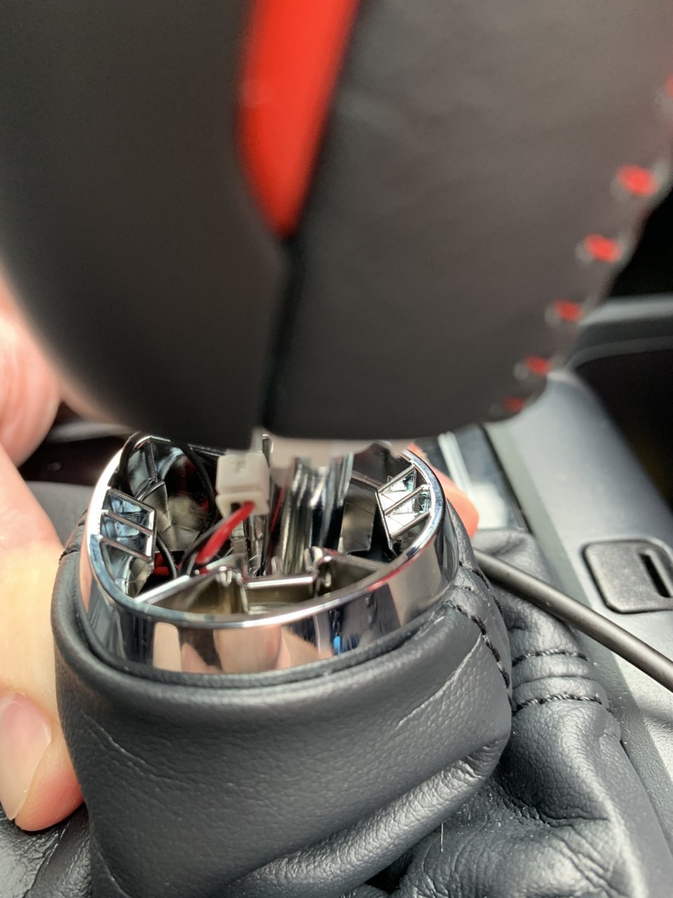

    Here is what I am running into, and I believe that @crazyfingers is asking about the same situation.
    Where and how do the small switch connecters lay between the knob and the shifter boot garnish?

    Yes that is one of them for sure!! The other is how to get the wires up thru the boot to the knob to hook them up.

    There is a hole in the very front and back of the chrome ring on the boot. I used the front one.

    Yeah, I couldn't find a complete video either but here are some tips that might help:
    You disconnect the stock wire from the back of the ECT button and attach it to the new wiring from the kit.
    You then basically feed the other end (with the smaller plug that goes to the shifter) down behind the Qi charge cubby.
    Lift up the shifter surround and look under the Qi charging mat with a flashlight and hopefully you'll see the end of the wire next to a stock yellow wire bundle.
    There's not a ton of space under there. You might have to pull the wire back and re-feed it down.
    I found that if I fed it down towards the passenger side it made it into a gap where I could see it below and fish it out.
    You then feed it up from underneath the shifter boot through one of the holes. I used the one towards the back.
    Screw the knob on and then connect the ends of the wire and then shove the small connection back down so that the shift boot collar can properly attach the the base of the knob.

    Put it through the hole in the back that is unused.
