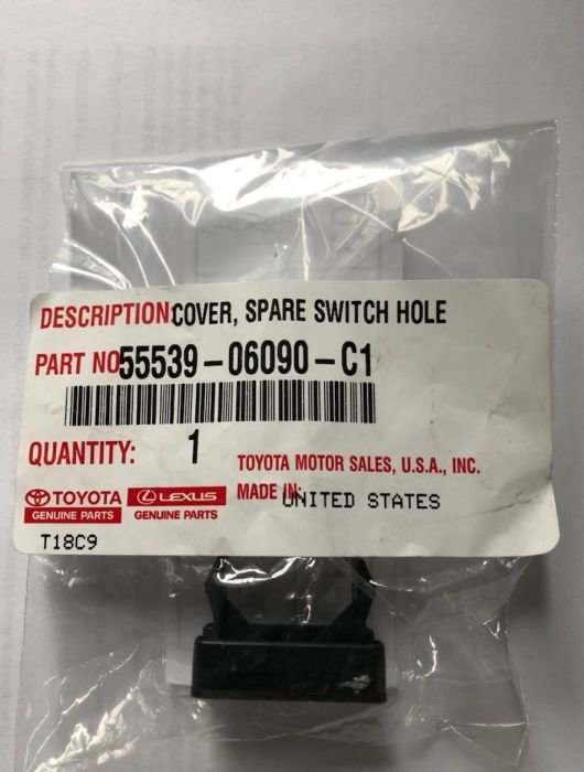

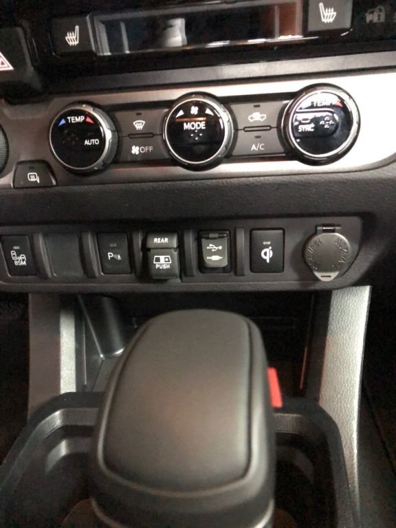

    finally found the time to install my Stage 2 shift knob. I wired in the garage door opener to the right side switch - works great. Both switches work great:thumbsup:. I removed the ECT switch from the dash and installed the blank switch. I will use that blank switch space sometime in the future for probably the any time camera mod. Anyway for those of you that need a blank switch cover, I have the part number on the photo below.
    I tried to move the BSM switch over into the ECT switch hole but the cutouts are slightly different. I discovered that each switch has small "tabs" on the side which makes swapping position of the switches a "no-go" without small modification of the dash cutout. So, I put the dash back together until I have some good lighting and time to modify the cutouts and install the switches where I feel they should go.

    Thanks for that blank pt# @4BYTOY

    Not a problem...it did take a bit of time to track down the part number; the online parts diagrams that I found were worthless for me. But my local parts guy is pretty good with his computer and found the dummy switch located on an obscure parts page. Anyway wanted to save everyone the hassle of finding the correct number for this smaller switch.
    4BYTOY
