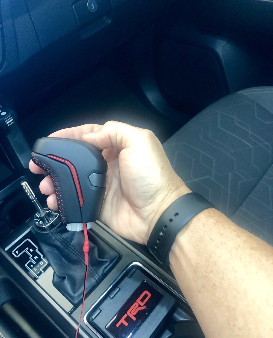

    17" Black TRD rims Tacoma Stainless Steel Rear Tailgate Letter Inserts Brake light flasher Center LED 110v and 2-3amp USB plugs mod in back seat center 400w on all the time mod SSR-610-40 SumoSprings 32 INCH 180W CREE LIGHT BAR (5D ) AUXBEAM BedStep and Pop & Lock Power Tailgate Lock Blue LED glove box light (fix no light) Bed light Blue LED's Wired to turn on when Gate is opened Tempered Glass Center Touch Screen Protector Rear Camera anytime Navigation Bypass ( a must) Rexing V1 3rd Generation Dash Cam hard wired in OXILAM 912 921 LED Reverse Light 2000 Lumens TRD Pro Grill TRD Skid plate
    Stage 2 red DIY
    happy i just got home and checked !
    Im thinking the second side will be to my hood scoop light, You know to flash the sob with there brights on !

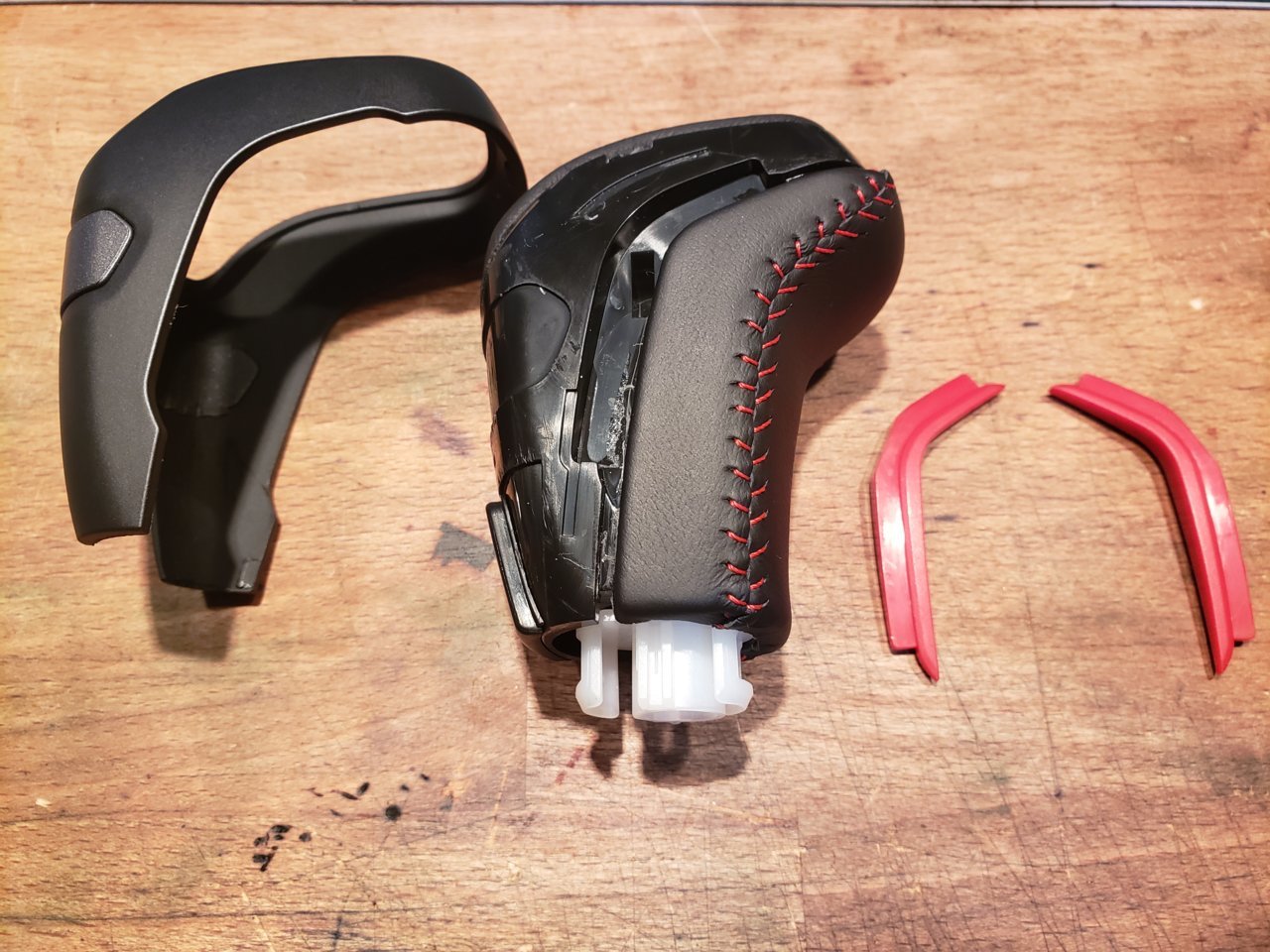

    @MESO u got a link for those picks you used in the disassembly video? Or anybody whose done it.

    Any hardware store should have them. May be called awls or picks. At first I tried using tiny screwdrivers but they were just too small to pry it apart. Definitely want to use picks

    They are called pick tool sets and come in handy very often. Pretty cheap too ~$7 for a set of 4. I got them here:
    https://www.homedepot.com/p/Husky-P...VjRitBh1NgwBOEAQYAiABEgLaQ_D_BwE&gclsrc=aw.ds

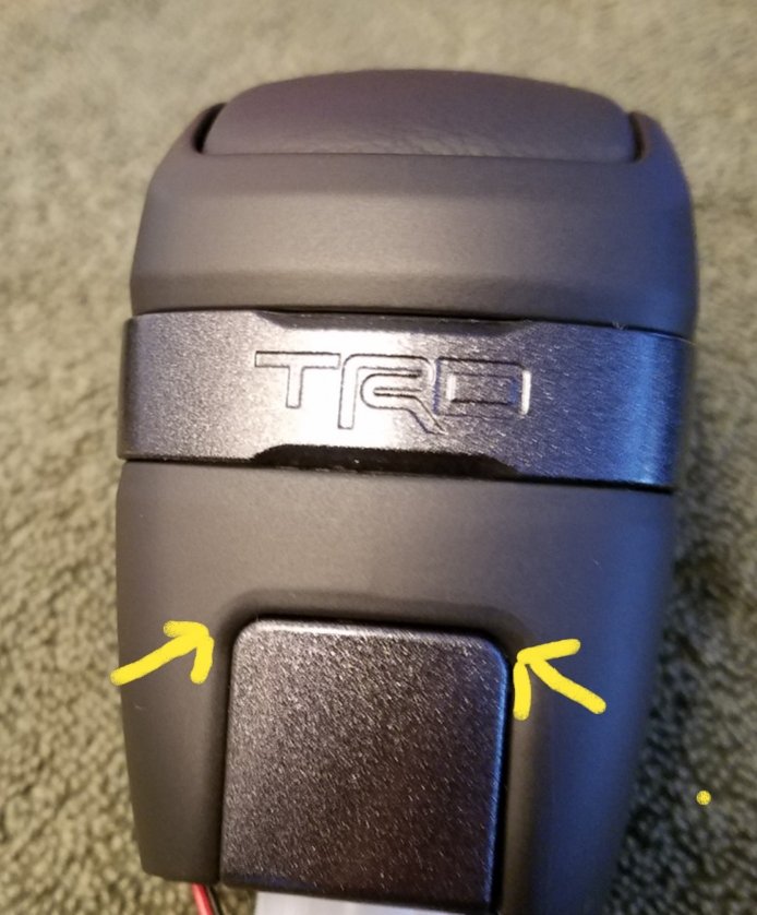

    Just have to make sure you get the tools far enough up inside to avoid cracking. I've heard a few people who went to fast and cracked it in the areas shown. Just make sure to watch these areas when lifting.

    Just a suggestion if you scored a kit and it's still cold where you are, take the knob inside and let it warm up for a while before attempting this. The glue/tape (mine had tape) will release easier if it's at room temp or warmer than if it's done when the temp is in the 40's or 50's.

    Installed stage 1 today. Didn't have any picks handy, so I used a couple tiny flat heads from an eyeglass repair kit. I also used a hair dryer to help loosen up the glue, didn't want to risk damaging knob. Wire fishing was fun, but otherwise love this mod. Thanks @MESO

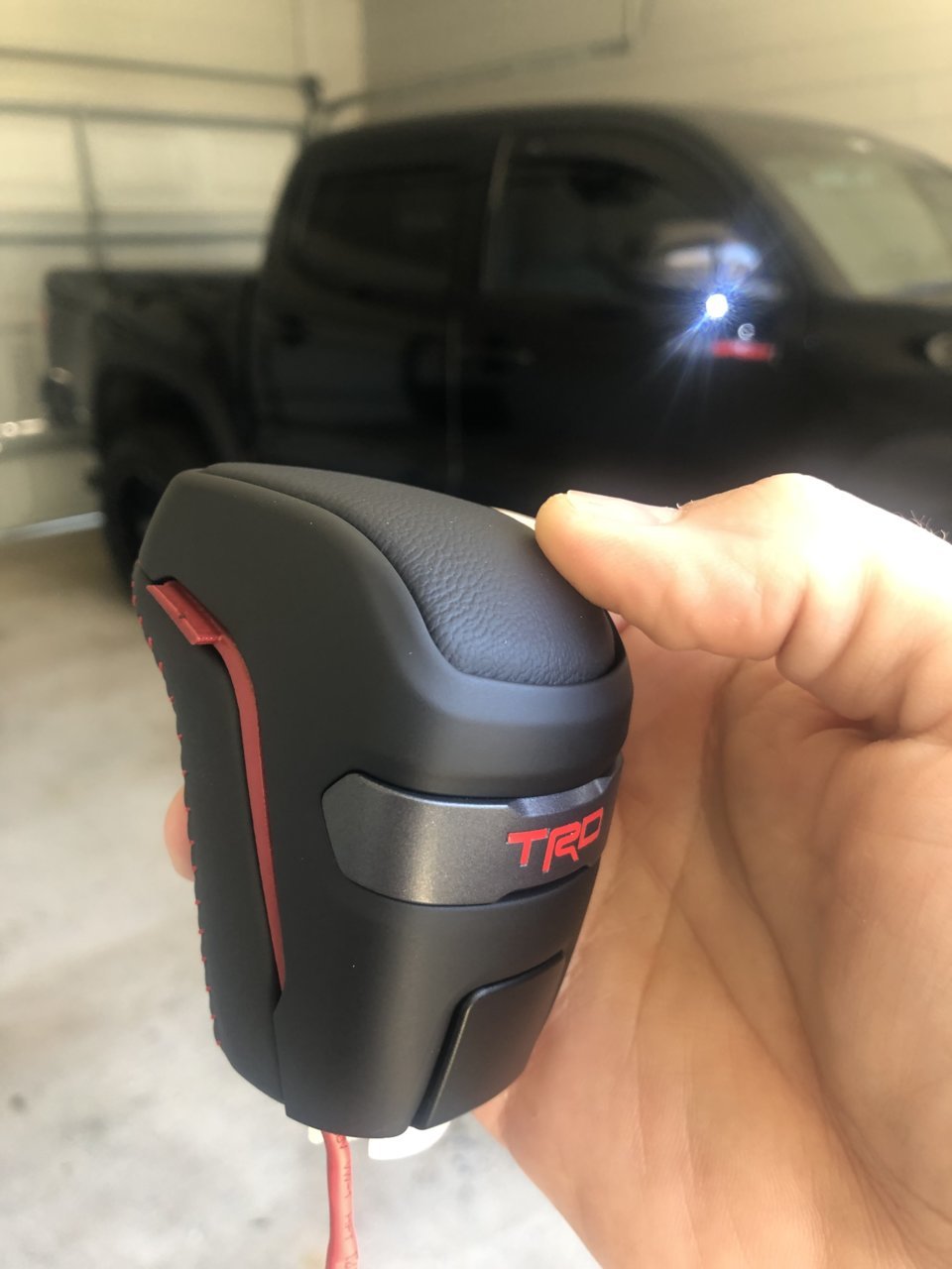

    Fits like a glove!!
    Thanks @MESO!

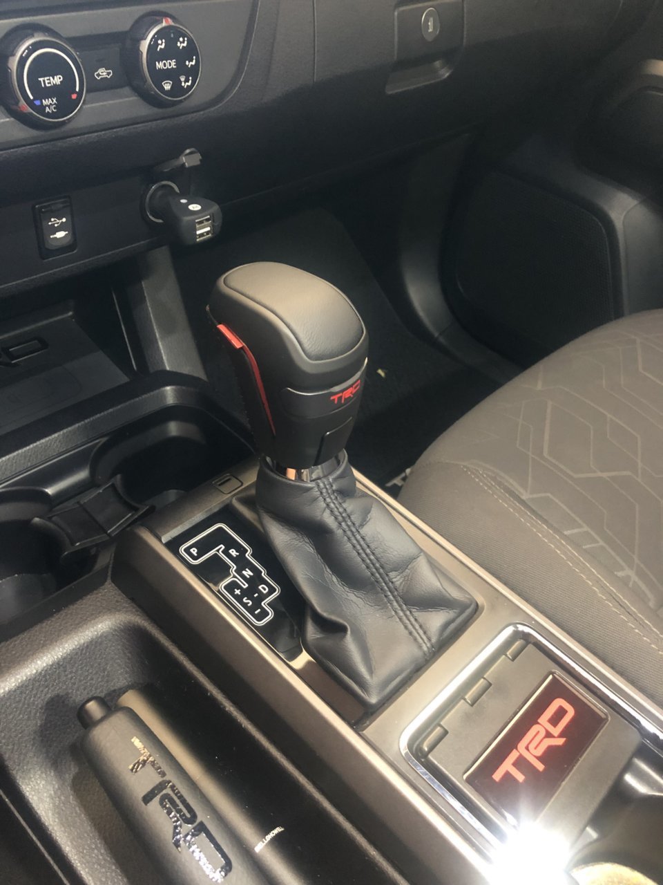

    Got mine installed, don't mind the mess lol
