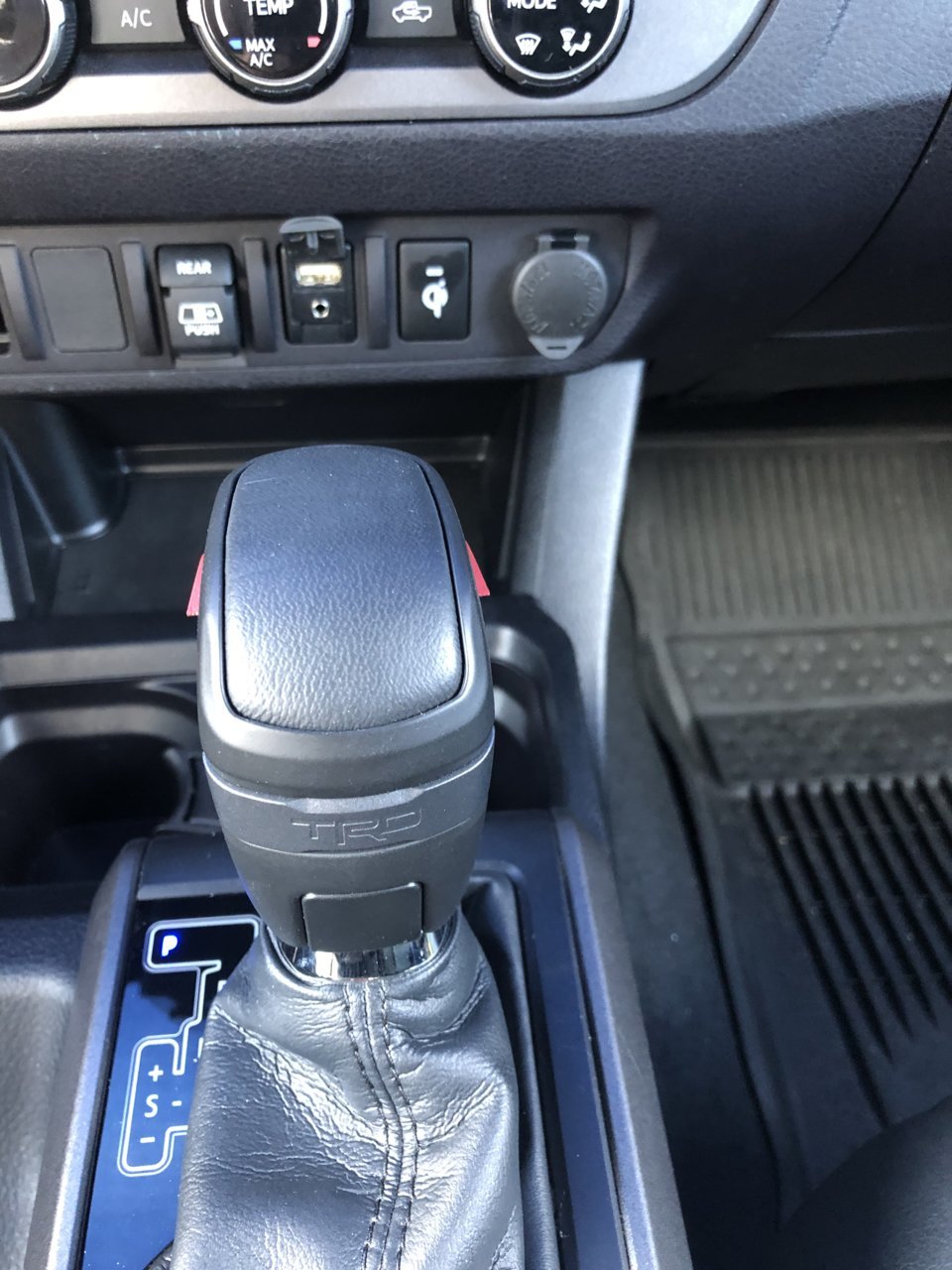

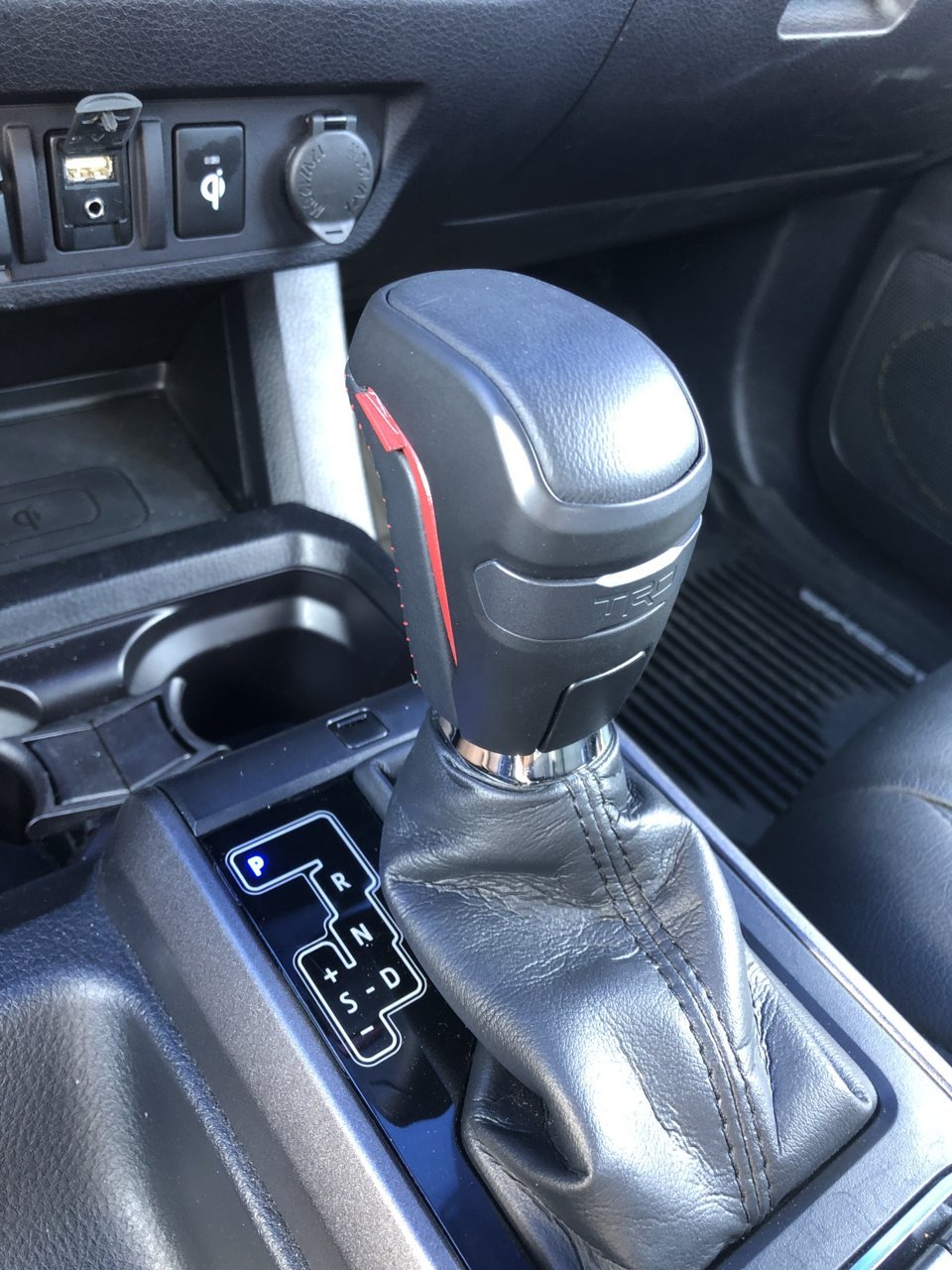

    Ok, so I had to sand some of the red paint off the area where the side of the switch contacts the case. Doesn't show because it's covered anyway. Installed by removing the two top dash panels and lifting the center tray up. I was then able to feed the new wire down to the center tray and up through the boot of the shift knob. Super easy install. Thanks again @MESO for another sweet product!673772B7-BE96-4A68-9081-A7EE8F084E8B.jpg29435A9F-B3B7-452A-9900-BCBC741045FE.jpg

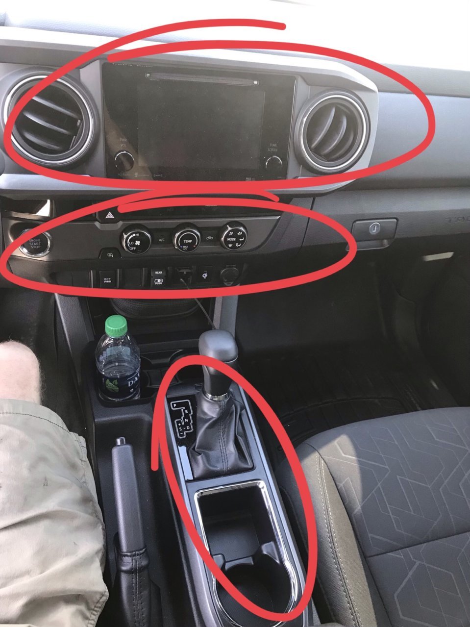

    Can anyone verify for me what needs to be removed to connect everything? Is it all pieces circled?

    Where the shift knob is, you take up the piece that the e-brake sticks out of. I found it easiest to pull up at the cupholder.

    I didn’t know that part needed up. Was just thinking the trim around the shifter would. So thanks.

    Post 217 in this thread has a video of Stew opening the front to get the ECT switch out. There are some other images around there as well with the bottom piece removed.
