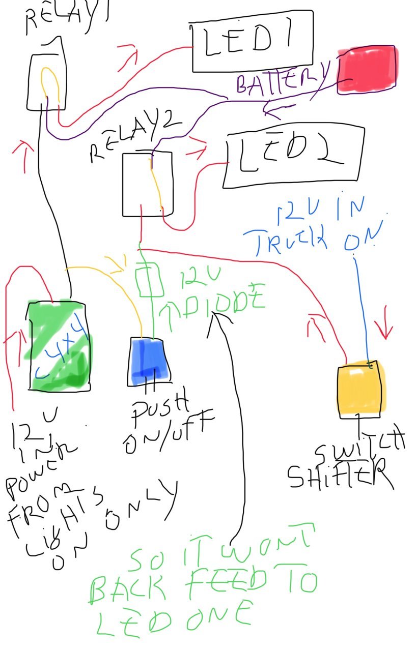

    this will, or may not help but.......
    LED 1 in grill
    LED 2 hood
    CH 4x4 switch only works with lights on, as to not have them running during the day
    LED 1 will power LED 2 switch, so both LEDs or only the grill will always be on when off roading
    Shifter has power when the truck is on, from the 12volt acc plug in center console all the time and will work as a LED 2 flasher only.
    YOU NEED A diode so it won't back feed and turn on relay 1
    i used a big 1/2 watt diode.
    PS i just like to wire my relays with +12 volt to the switch not -12 ground
    Works for me as have had it for a week now
    drawn with my finger on the iPad .. high quality ...lol

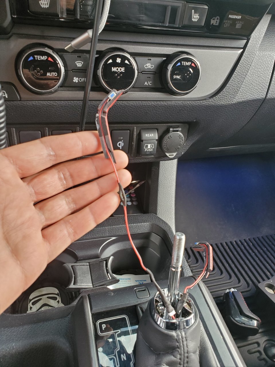

    With a little help from MESO I was able to extend my wiring a little bit longer today making it a tad easier to reinstall everything. I was one of the guys who had a pin that popped right out originally but as always Stew goes the extra mile to make things right. So not only was able to fix that but like I said was able to lengthen the wiring a short bit. I also reinforced some parts with heat shrink tubing.
