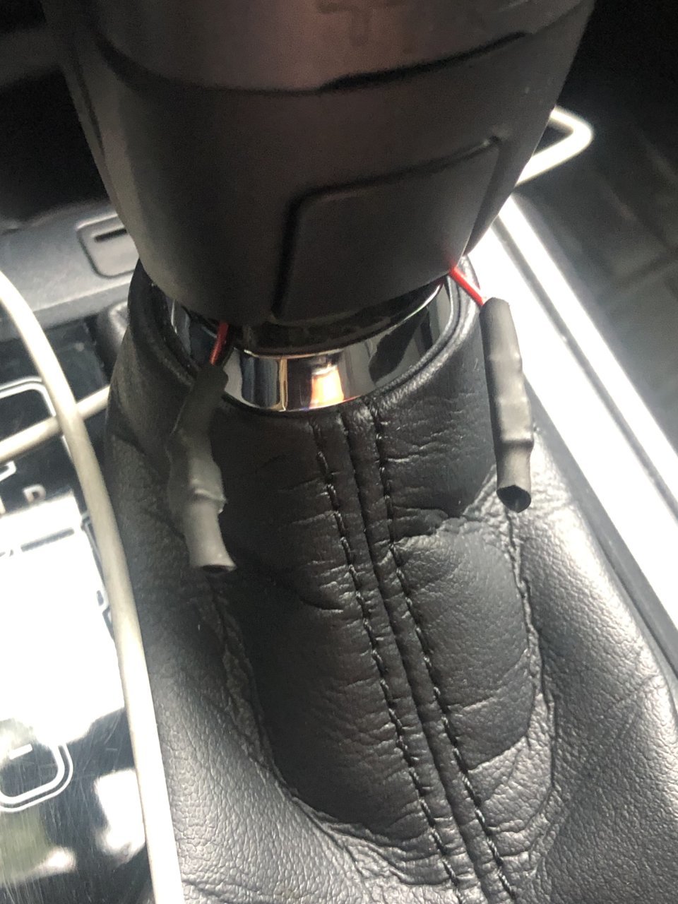

    How is everyone routing the wires to the knob? Mine keep getting pulled out after about a day of driving......

    I ran mine behind where the ECT button is down to the left. Then A long the Passenger side consul then up to the shifter. Mine has not come on hot ones and I do not have their shrink wrap or anything holding the plugs together.

    I had that issue too, when I routed the harness on the passenger side. Once I moved the harness on the driver's side of the console, I haven't had them disconnect at all. I was even able to remove the heat shrink.
    And I shoved the connectors into the white part of the knob. Like in @kjhadfield's post below:

    Just tried the pass side routing this time. Both times on the driver popped out. I did it use shrink this time just in case. I’m getting pretty good at this center console removal. Had to do it on the side of the road last weekend when I took the munchkin to Mt St Helens. The hills sucked without it working. :)

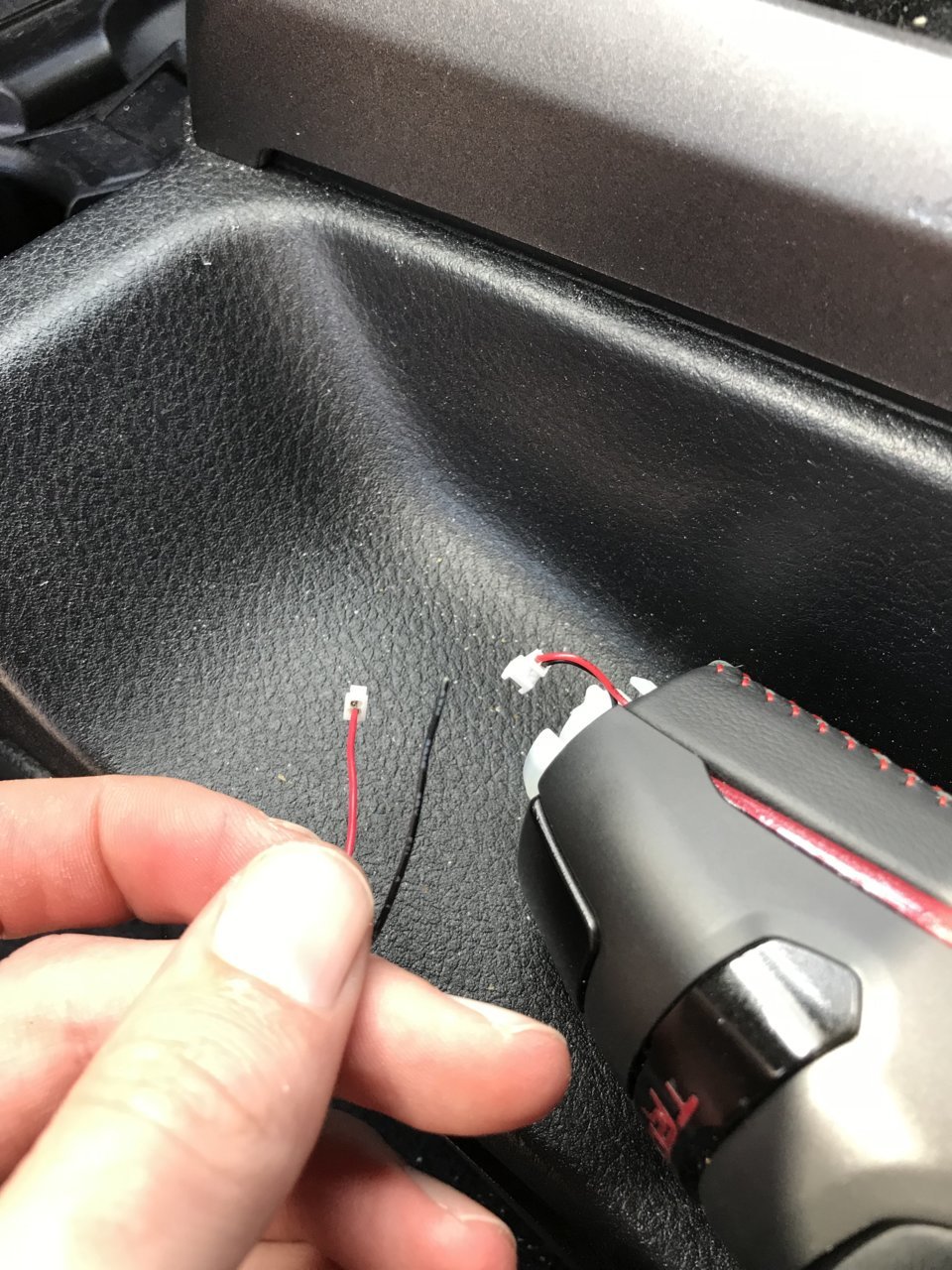

    Yeah, annoying. The other end of the wire is still in the connector too. This is from his first initial batch of 20 knobs, and haven’t had an issue with it for months since install. Last night ect wouldn’t work. Just popped the console and this is why. Guessing it had too much tension and just snapped while shifting. I’ll be trying to fix this tomorrow when I do my speakers. I hope I can fix it, I’m not the most dexterous person when it comes to very small objects that need work
