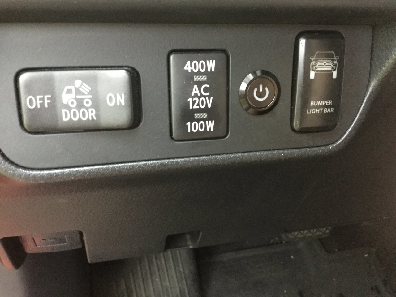

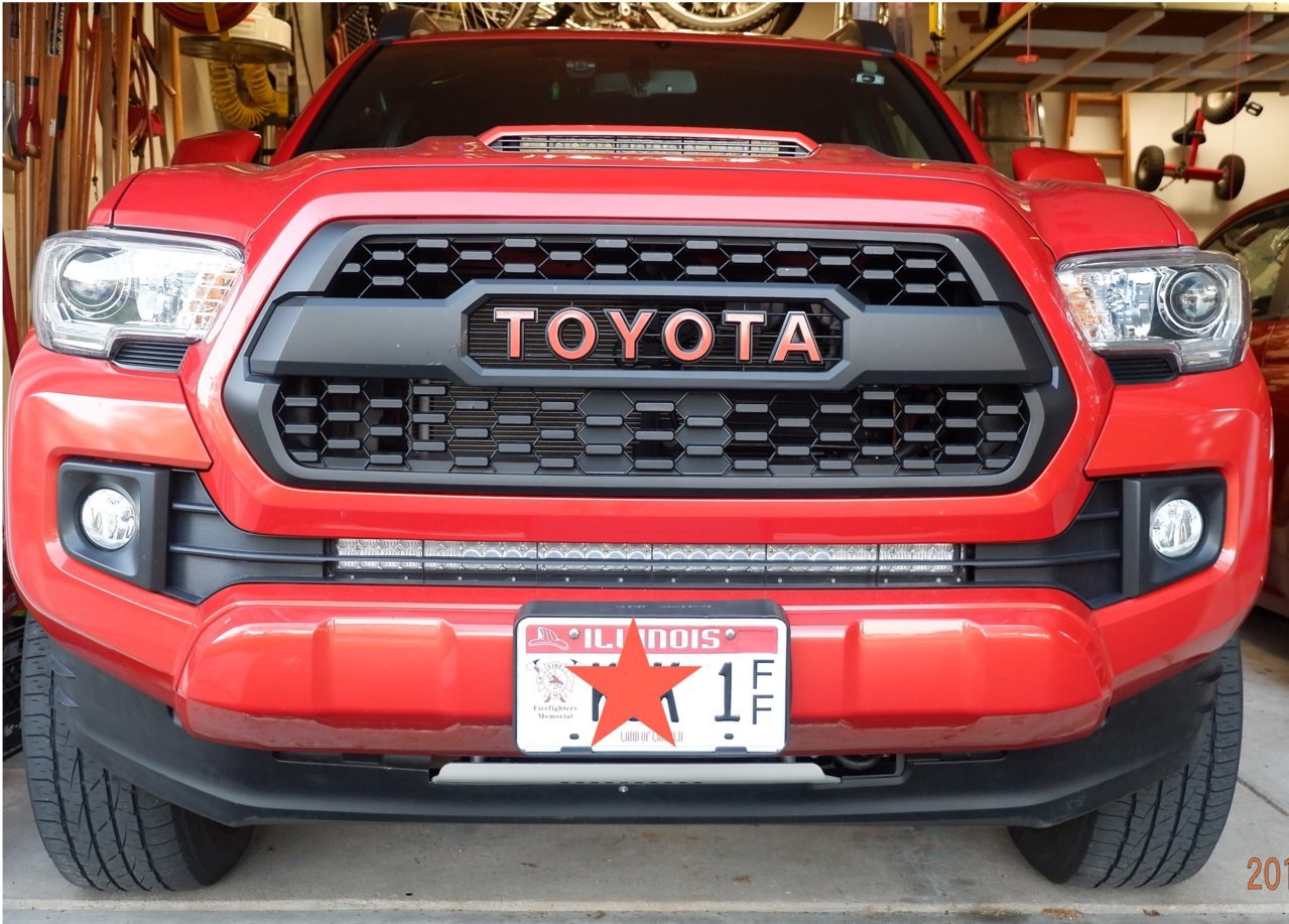

    I hooked it up to my hood LED bar as a flash and have a 2nd switch for always on. You can do it easily with a 2nd relay or like i did with a diode so the flash will work anytime and the "always" on will only work with my lower 32" LED bar so I'm don't accidentally have it on going down the road, the flash is good to get people to wake up at a light.

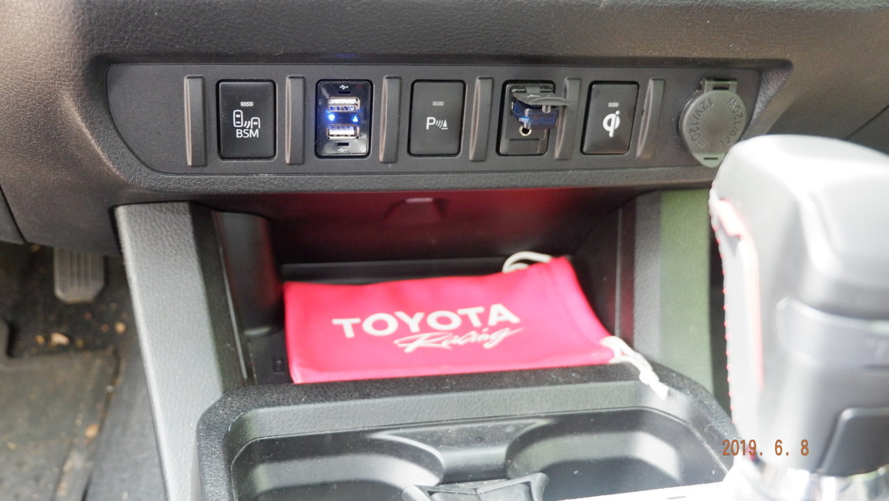

    And i replaced my ECT switch with the usb charger i posted below.
    and yes that's a TRD skid with the lower cowling on mod
    MICTUNING [New] 12V/24V 2.1A Dual USB Power Socket for Smartphone PDA iPhone iPad GPS Charger for Toyota

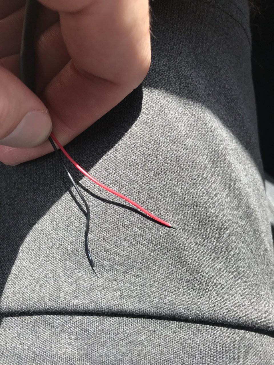

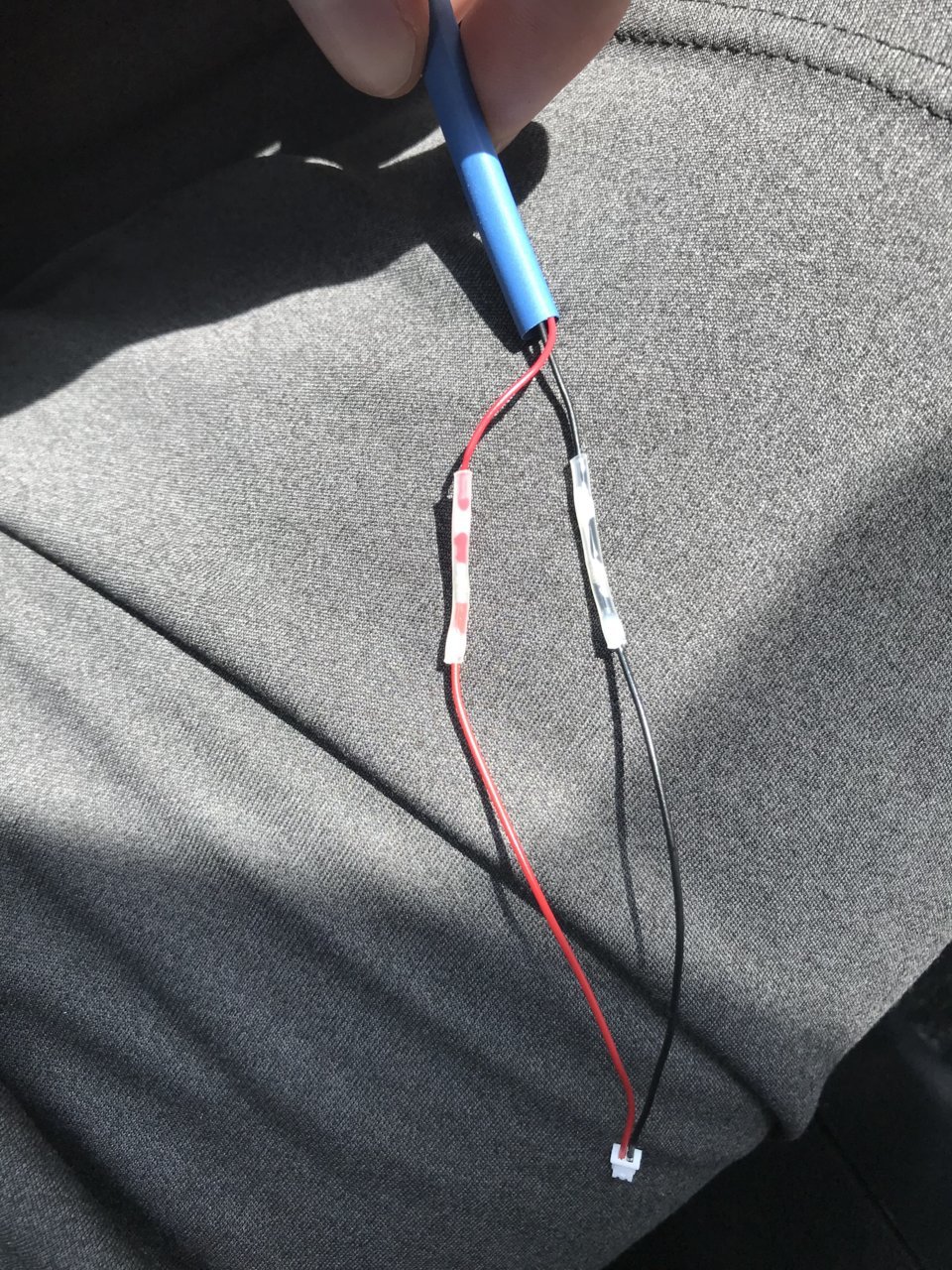

    Sooo it took me a while to get around to it since life has been so busy, but just want to thank Stew @MESO again for the awesome customer service! I’ve had my stealth knob since the first batch, and unfortunately one of the wires from the micro connector popped out. Stew had a shipment sent to me, while he was in China, to help me out. Sent two new connectors with the wires already installed. Managed to get it up and working again without even having to remove the harness from the truck. Tried out some self soldering connectors for the first time and it worked like a charm!
