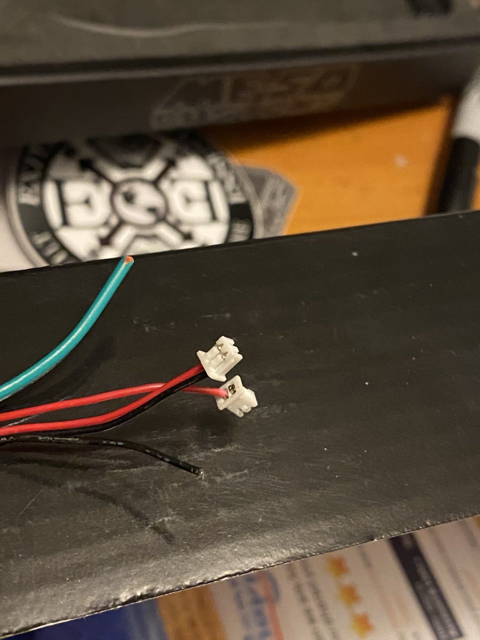

    Need some help. Ground wire ripped off the connector on Meso stage 2 harness during install. Does anyone have a fix? @MESO do you sell connectors? Or harness separately DC323C29-B974-49B7-AF03-057F8A6CC846.jpg

    Can you tell if it pulled out or broke? If you know how to remove the metal pin from the connector it should be an easy fix. Hard to explain.

    Pulled it from crimped pin

    Without having another connector, the only thing you might be able to do is de-pin and open the crimp, re-crimp and solder. But that pin looks tiny haha.

    That's about all you can do or if crimp looks to hard to open without messing it up then just solder it. That way you can finish install or wait for Meso to set you up.

    Yep my one side pulled out too. All my fault so I bought the do it yourself kit and I'll just replace.
